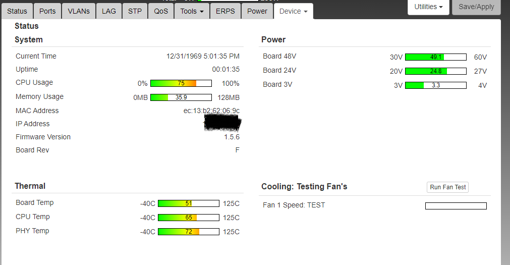

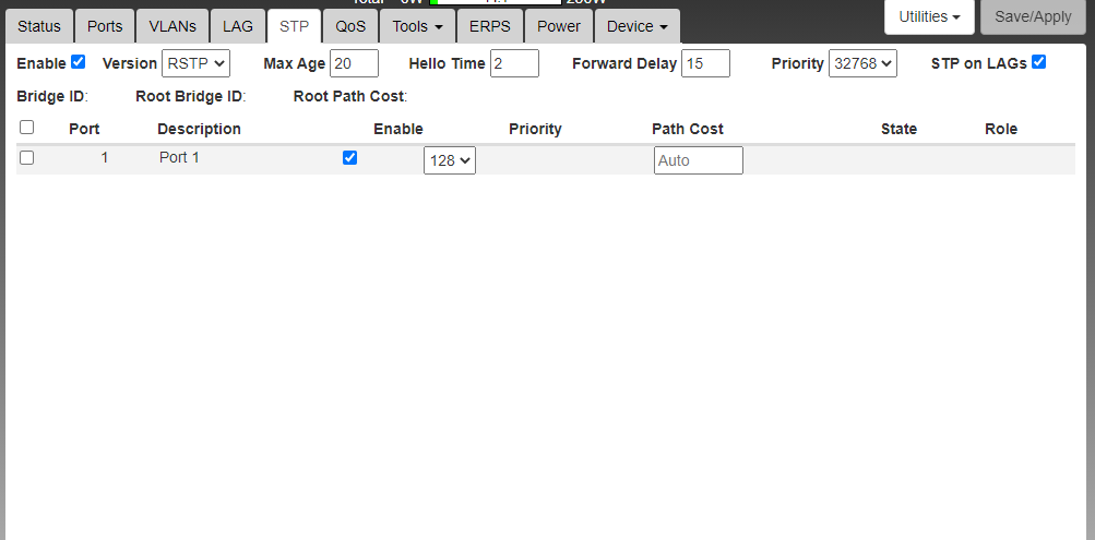

We have the issue when updating some of our switches that are in the 1.5.3 software version. I believe it happens only on switches that we have at one time or the other modified the STP settings. The issue occurs even when we change the STP settings back to factory defaults before the upgrade.
The below presented example is upgrading to 1.5.6, but it also has the same symptoms when updating to 1.5.5 and 1.5.8.
The STP tab will only show one port as seen in my attached screenshot.

The Status Page will show high CPU load and the Fan test gives no status.

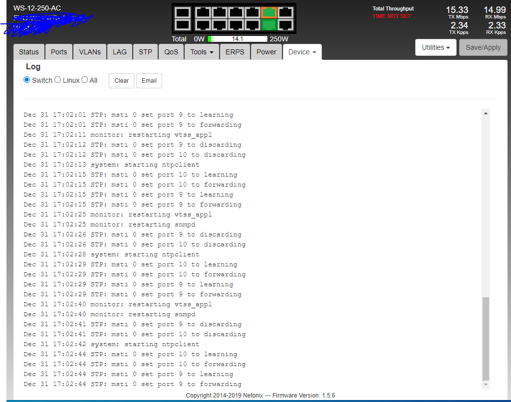

Last but not least, the Log Page shows vtss_appl and snmpd restarting regularly with the time not set.
