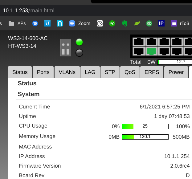

Update on this: While troubleshooting the switch I attempted to set the address manually over RS232 to a static IP. This did not work (switch reports an IP of 0.0.0.0) I then re enabled DHCP via RS232 and the switch flooded me with a wall of text for a few minutes before a process crashed and the switch rebooted. I've attached a text file containing the RS232 wall of text. Note that I can't post the entire wall as the same message repeated so many times and the console history only goes so far back.
Another Update: When this switch was being validated by another person they observed the switch retrieve two IP's over DHCP and both IP's were able to access the management console. Photo is attached. Note that the IP reported by the switch is different than the IP in the browser bar. Also note that the MAC Address has been intentionally removed from this image.

And another quick update. When the switch isn't locked up it seems to be switching it's IP between 39.0.0.0 and 0.0.0.0 Those IP's are what show up in Discovery on the WS-12-25-AC that the WS3 is connected to.

Also another update: The same wall of text has now been triggered simply by disconnecting a patch cable that had an active link from the switch. The switch also continues to lockup on every bootup and it is appears to be the same PHP error.

On every boot now the switch locks up for approximate 10 minutes. I call this a lock up as unlike the normal boot process the switch consistently errors after the lockup clears. The error is always the previously mentioned PHP error repeated many times. After which the CLI presents as if nothing happened. This first occurred after I rebooted the switch via the RS232 interface.
