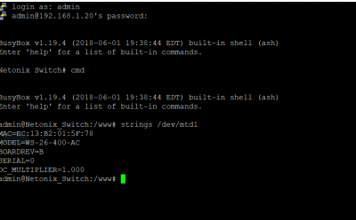

In Putty over a serial cable, try running the following commands:
Code: Select all
cmd
strings /dev/mtd1
And let me know the results.
Saint George
Posts: 6
Joined: Thu Apr 29, 2021 4:23 pm
Re: Switch issues
Thu May 06, 2021 10:32 am
Capture attached, not much to see. I guess its heading to the dustbin. Thx
