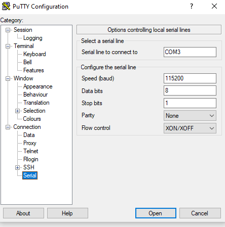

Well maybe we can try one more thing before you RMA it, or at least confirm some of the issue's we're seeing.
If you are able to run the serial recovery tool then you should be able to view the serial output via the console cable you have now.
Try running putty,
use these configurations (except find the COM port your switch is on, use Device Manager to do so)
Connect everything up before the switch boots.
Then when it boots you should see lots of output on the screen.
It'll take a minute but eventually (if everything is working) you'll see output that looks like this:
When it gets there, try running the command:
If it doesn't return back immediately, give it a couple more minutes and try a few more times.
Let's see how far you get before you RMA.
Also, once you get it to boot with the PuTTY output working, try and capture everything and post it here for me so I can examine the results.

Try running putty,
- Code: Select all
Netonix Switch#
- Code: Select all
show status

Once the recovery tool has started it will interfere with normal operation of the switch.
Try shutting down the recovery tool. Opening a PuTTY session, then power down and power back up the switch with PuTTY open and the console cable attached. The PuTTY session will remain open through the power-cycle and you should see output on the screen.
If you still do not see any output on the screen, then you definitely need to RMA the switch - as it means it's not reaching the boot sector in the flash.
