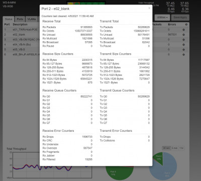

Hello,
We have been struggling for 1 week with a problem without a solution so far. :headb: :headb:
We have a WS-6 Mini that gets feed by an Airfiber 60 Ghz LR that is showing loads of RX Drops.( as in attached picture)
To solve the issue so far we have :
- Changed port on Netonix (from6 to 2)
- Changed Cable
- Changed Airfiber Antenna
- Tried MTU 1600 on Netonix
- Upgraded switch to latest 1.5.8
None of the above solved the issue.
The reason we have not changed the Switch yet is because it was working well and without any errors with Airfiber 60 (not LR) .
Anyone experienced something similar?
Have to say that we have few other links Airfiber 60LR that terminate to same models of Netonix with firmware 1.5.5 ( did not update them) and they show no errors at all thus making this more bizarre.

Duplex mistmatch ? Else, faulty LR seem the most probable since you didn't change anything else. Firmware upgrade available for the LR ?
