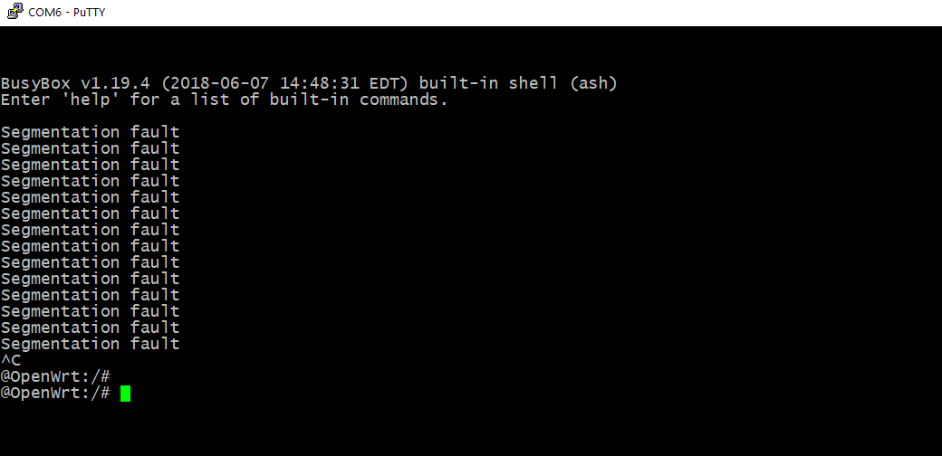

Have a WS-26-400-IDC that's been acting up, so figured today is the day to replace it.
Updated the firmware without a problem, then when I attempted to restore the backup from the old switch, it became completely unresponsive.
Serial console got me to an OpenWRT prompt. Was able to run the recovery tool. Tried firmware 1.5.6 and 1.5.0. Both results in Segmentation faults.
What's next?

Re: New WS-26-400-IDC Bricked?
Stephen,
Doesn't appear to be anything special in /dev/mtd1, so here it is (along with the last of the boot messages, etc...
- Code: Select all
switch: 'Luton26' board detected
nf_conntrack version 0.5.0 (2048 buckets, 8192 max)
i2c /dev entries driver
i2c_vcoreiii i2c_vcoreiii: i2c bus driver on IRQ 19
mini_fo_lookup: ERROR, meta data corruption detected.
mini_fo_d_delete: negative dentry passed.
mini_fo_d_release: no private data.
^C
Please press Enter to activate this console.
BusyBox v1.19.4 (2018-06-07 14:48:31 EDT) built-in shell (ash)
Segmentation fault
Segmentation fault
Segmentation fault
Segmentation fault
Segmentation fault
^C
@OpenWrt:/# strings /dev/mtd1
MAC=EC:13:B2:11:D8:20
MODEL=WS-26-400-IDC
BOARDREV=B
SERIAL=0
DC_MULTIPLIER=1.000
Ah OK, so that start up output at the beginning:
Along with the other symptom's you've described, is a strong indicator something is wrong with the flash.
At this point I would say you need to RMA the switch. Please go to rma.netonix.com to create a ticket.
- Code: Select all
