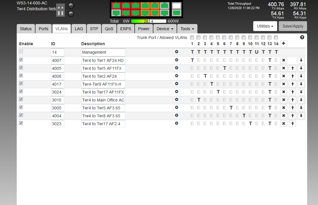

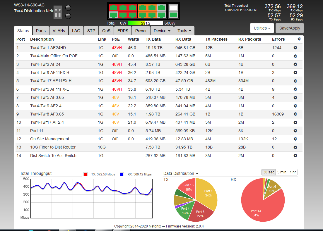

Deployed the first WS3-14-600-AC into production and when we got it in place the management vlan isn't passing traffic. All other vlans are passing traffic just fine like they did in the lab. Should have tested the management vlan. Weather has kept me from going back on site to take screen shots but ospf vlans are tagged to the corresponding tower and work perfect and the vlans tagged across the SFP+ ports pass just fine but I cannot get tagged management vlans working. I have tested this on a backup WS3 with different router and nothing on management is passing. We are using Mikrotik CCR routers and the same setup with the original WS has worked just fine.

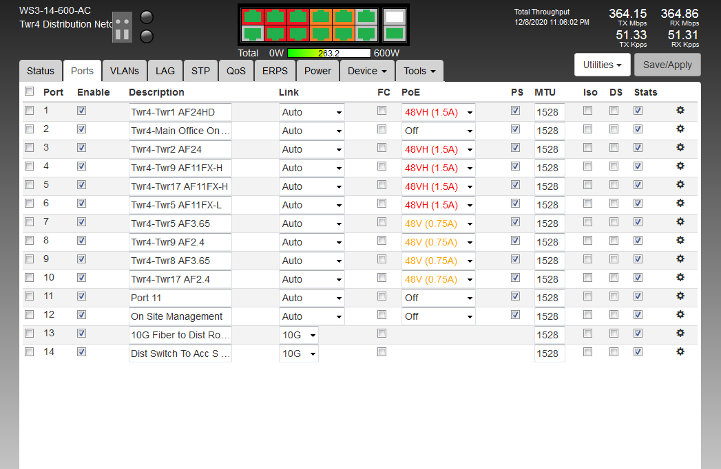

On another note when we initially power up the switch or turn ports on or off the OCP kicks in. Good feature to have but at 18 degrees in the wind its not fun. If I unplug the ports and clear the OCP then plug it in they power up fine but it takes a person on site to work on anything. I have also had this happen in my lab with nothing plugged into the switch with the ports powered on.

We are investigating, in the mean time do you mind posting your Status, Ports, VLAN tabs and the logs. This is the beta release for WS3's so there might be a bit of tweaking we need to do. But I did not encounter this issue during testing. Also which Mikrotik CCR are you using exactly? I have one of my own just want to try and test it with as close to the same model as possible.

Here are the screen shots and logs that I got. You can see where I had to switch ports 2 and 6 around to power the AirFiber 11. We used a power injector on port 2 to power the powerbeam since it wasn't that important.
