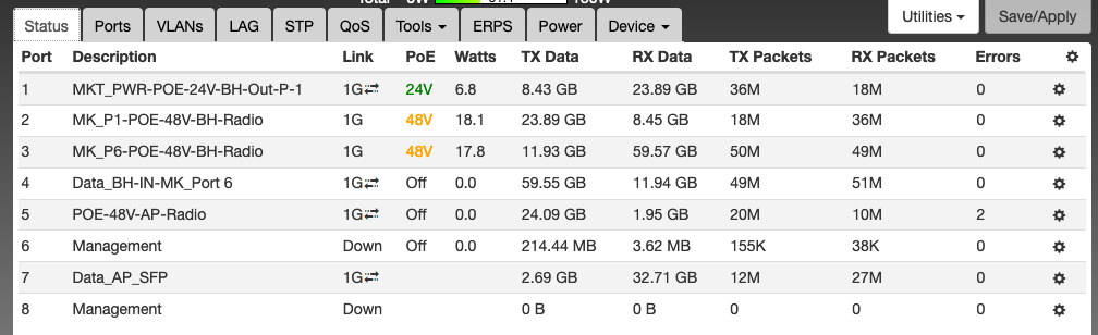

So I checked all my cables with a tester and they test good - but my Mimosa A5c seems to freak out my WS-8-150-DC - but not always.
I have like 7 of these deployed in the field.
Two sites now have exhibited the following symptoms.
Everything is fine and peachy keen until one day I start getting messages in my Netonix log that port x (Lerts say 5) has dropped to 100 meg Full duplex (or 1/2 duplex on one occasion).
If I bounce the port or POE bounce it (48V) - it tried to negotiate at a gig but fails and then goes to 100. If I run a cable test - the whole switch freezes and reboots until you remove the cable for POE form the Netonix.
I have had this happen on two switches with repeatable results.
Last time happened just a day or two ago - I went onsite, and plugged in a console cable, and an Ethernet cable. Console would NOT RESPOND until i removed the POE cable from port 5.
Plug back in port 5 - console stops responding! Unplug - it is fine.
In the end I have swapped to the Mimosa POE Injector and all is well.
As I said before - this is the 2nd location that I have had this same repeatable result at.
5 other locations all set up the same - do not have this issue. So weird.
I did at one point reboot the switch and plugged in the AP cable to see if on boot it would work / auto negotiate - If I forced to a gig - it would bounce all of the time.
Are there logs I can pull / info that I should look for ?

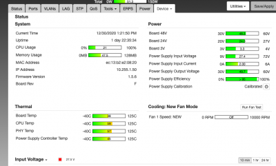

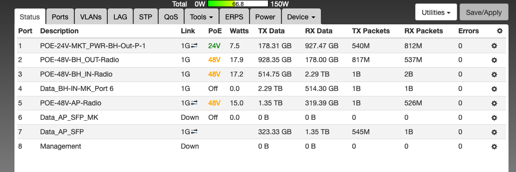

mcnnetops
Posts: 37
Joined: Wed Nov 07, 2018 2:58 pm
Re: 1.5.6 Mimosa A5c freeze reboot Netonix switch?
Wed Dec 30, 2020 5:28 pm
So of course - I dont have voltage graphs when this happened - They exist now! (Although may not have mattered as you dont get any data from it snmp or otherwise when in that state.)
Here are some snips of status (Device) page now (no POE on port 5 for the AP)
And the status page (Main) showing current draw - currently 2 BH's that are Mimosa B24's.
Heck - last picture is current draw form a working site with port 5 powering the Mimosa A5c:
Enjoy:
Device (Status) page
Status (Main) Page:
Other site with Mimosa A5c (with more customers too):
Other Site Powering A5c
I will say that the wattage seemed to peak when I took this last pic (good as far as I am concerned)

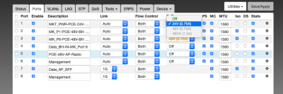

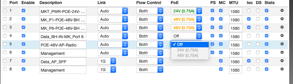

mcnnetops
Posts: 37
Thu Dec 31, 2020 2:00 pm
The WS-8-150-DC does not support 48VH on port 5 - See pics.
I could give that a try I suppose and swap for port 1 -
Why do you say this however? What is the thinking? That the 48V (low / normal) does not have enough juice to run the A5c? Or that 48VH sends power through more wires on the cable?
From another post (viewtopic.php?f=6&t=2943) :
"But yes the MAIN difference between 48V and 48VH as Les said is 8 wires verses 4 wires caring power."
Dont want to just try this and smoke my A5c!
:P
My concern is that something is causing the Netonix to freeze when the A5c is doing "something" - and not sure that is - but I can re-produce it. If I do however it will take the sit off line -
I really want to nail this down as I currently only 1 wireless customer and an Ethernet customer off this location. So the sooner I get the solution the better!
Port 5 No 48VH option:
Port 1 48VH option:
