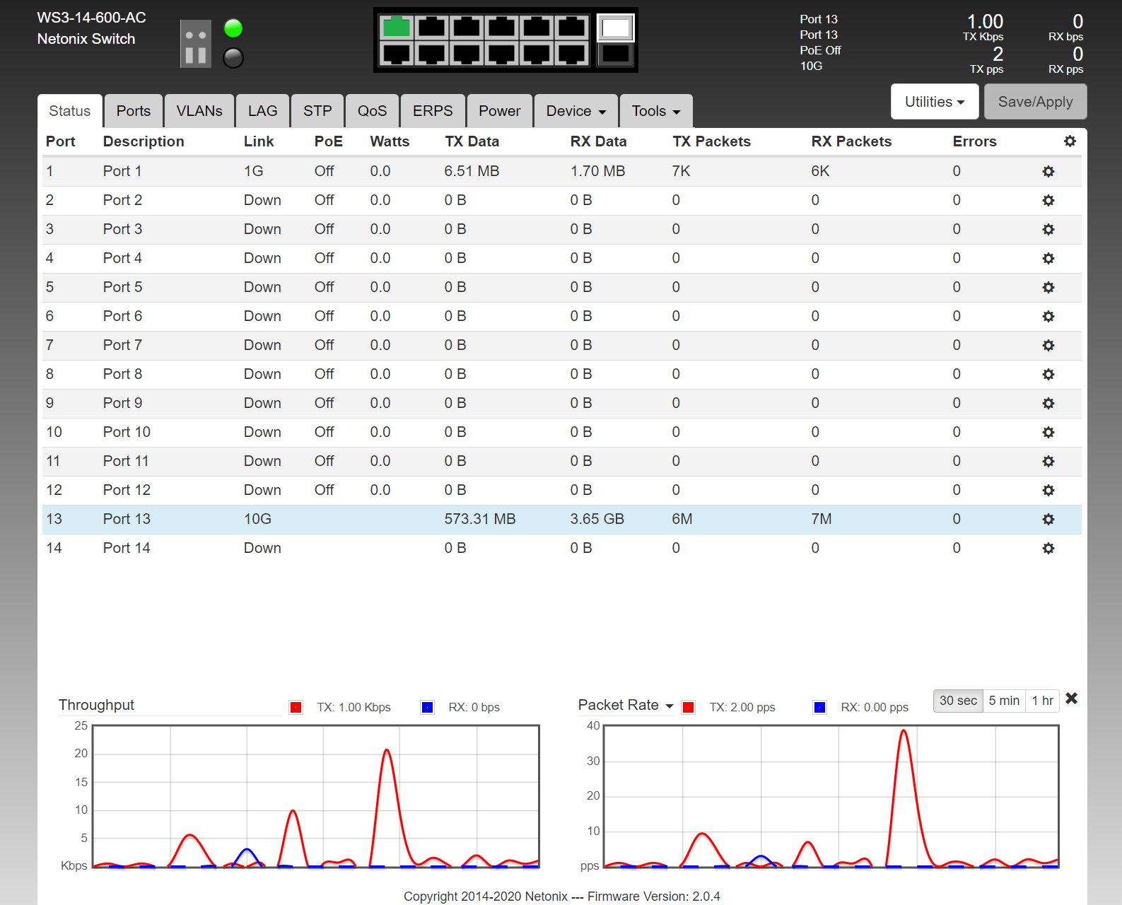

When the link is at 10G, it should look like this on the web UI:
What does the firmware say at the bottom of your page?
Can you share screenshots of the Status, Ports and Device->Status tab?
