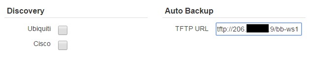

I love the TFTP Auto Backup feature. Basically if you have a TFTP server setup in your NOC you can have the switch backup it's config each time someone saves/applies any changes.
So basically below I have the URL to the TFTP server and the file name to call the config
TFTP://206.XXX.XXX.9/bb-ws1
The backup file that it will create is "bb-ws1-XXX" where XXX is the unique config number so it does not overwrite the previous config backup.
This way if I lose a switch I can grab the config from the backup server and load it into the replacement switch and I am back up and running. We also have our Cisco routers backup to this same TFTP server so I always have the backup config for the routers as well. So in the event my tower gets hit by lightening and I lose everything I can grab a spare router and switch off the shelf and within minutes have them configured to drop in.
Also this version we but in arrows to move defined VLANs up and down in the list because you might want to reorder the list to make logical sense to the user, neat little creature feature.
And now as far as I know all the CLI commands are in so you can completely configure the switch in the CLI.
