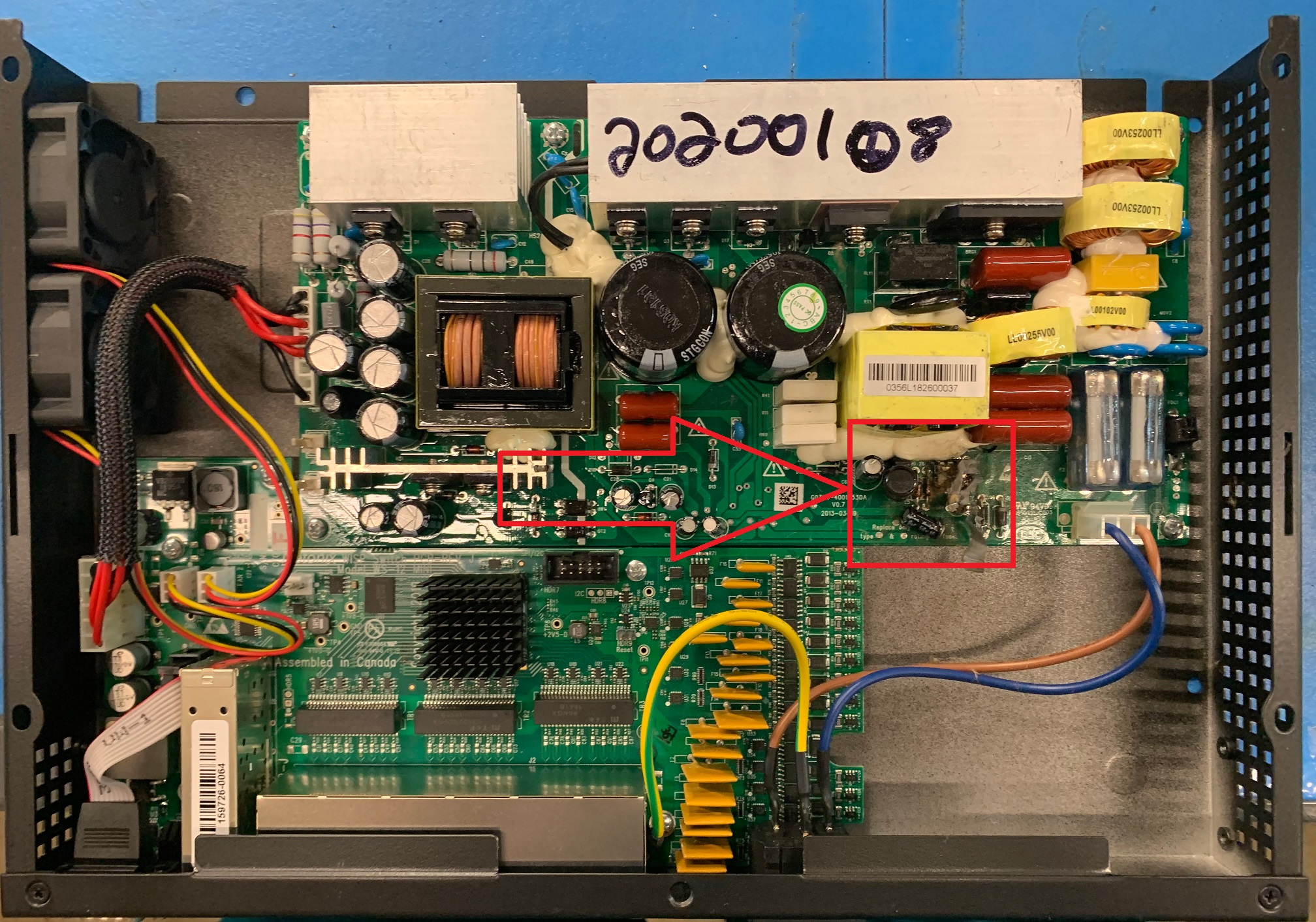

I "think" I do remember the unit your talking about which Ian showed it to me, the AC power supply was fried with big burn marks which would indicate a surge from the AC power side.
Ian should have uploaded the picture to the RMA portal for your review, I am having him do this now and change the status of the RMA to Repair and Completed so you can get it back after you pay for the repair.

Here is a picture of your unit.
Notice the damage is on the AC input side of the power supply which means a surge came in through the AC side and fried the power supply.
I also am having him include your old power supply in the box when returned so you can clearly see first hand why this is not warranty.
I am sorry it was only in service a short time and this happen to you but this is not out fault.

By the way surges do not only occur during storms, sadly sometimes they just happen.

Amazing considering it was connected to a UPS and NO OTHER EQUIPMENT WAS DAMAGED IN THE ENTIRE BUILDING.....TIME TO FIND ANOTHER VENDOR FOR SWITCHES...................THANKS FOR NOT STANDING BEHIND YOUR PRODUCT YET AGAIN, I'LL NEVER BUY ANOTHER ONE...
