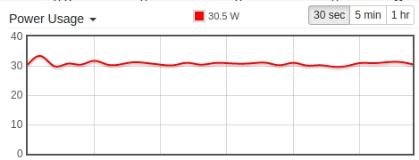

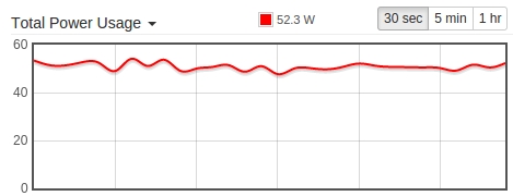

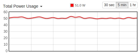

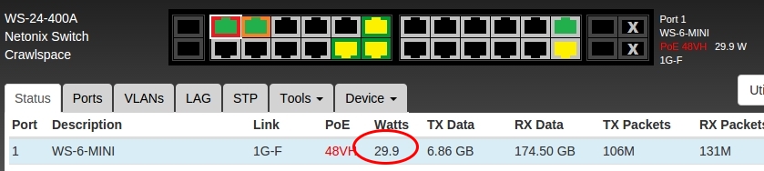

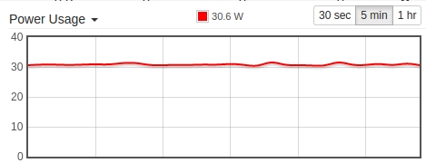

The wattage shown going out port 1 that feeds the MINI is reporting less than the MINI reports.
he numbers on the MINI appear to be too high.

Well, the watts are updated every second so is it possible they are fluctuating? - PROBABLY NOT THAT MUCH
Can you post some current graphs, 30 second & 5 min ?
I would post the 24 port graphs feeding the WS-6-MINI
I am wondering if in the new firmware version Eric is not adding the 2 pair current sensors?
When using a VH port Eric has to add the 2 current sensors together, I am thinking there is a BUG in the new v1.2.0rc6 where he is only reporting half or 1 pair.
I am betting he is only reporting 1 pair/sensor value.
WHich would make sense, 60W's seems about right, I would bet that the load varies 5-7+/- watts from reading to reading possibly?
We should have put a sensor on port 1 to read the input current, maybe next spin.
So if you assume 24 port port 1 is reporting HALF if actual load then 59+ watts and the 6 MINI at the moment you took the screen cao is 57.7 watts that lines up pretty good.
