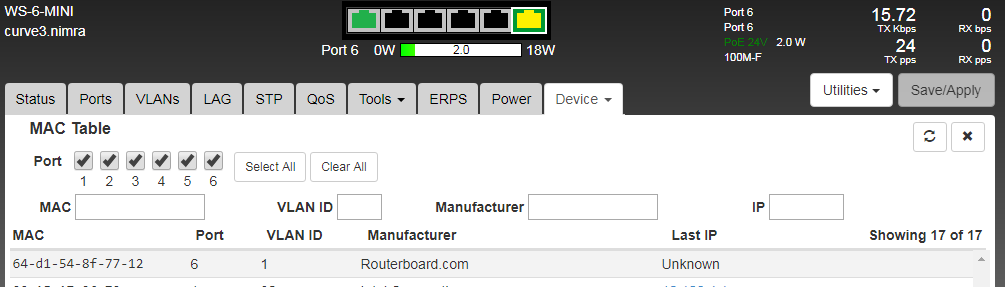

In version 1.5.5 (on WS-6-MINI). Tested on port 6. Screenshots are included.

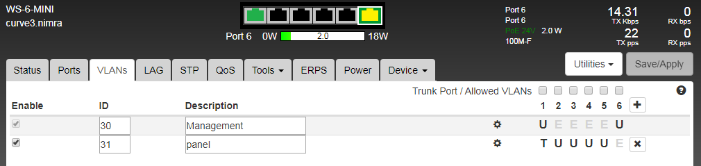

Port has only one VLAN, untagged management. Everything working fine. If I disabling port 6, data not forwarded ( :-) ), POE still powering plugged device.
Next step is cold reboot.
After that, enable port 6. Data not forwarded, device's MAC is found in VLAN 1 (that not exists!).
Workaround: edit VLAN on port 6 (exclude, save config and set back as untagged).
