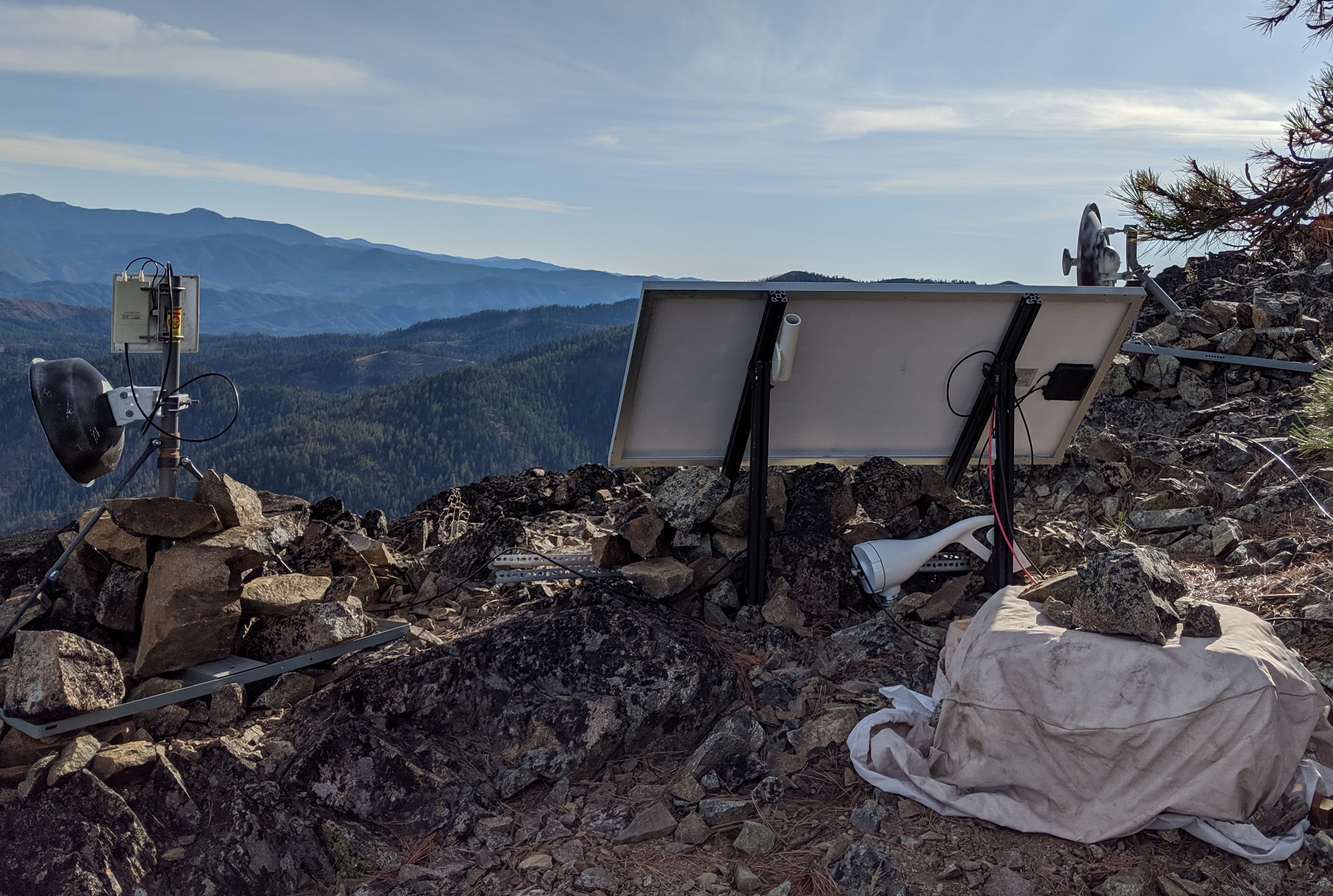

All of my links are up but the switching side of the WS-150-8 is dead. None of my raidos have a LAN wired connection says unplugged but the switch is still sending power to radios just fine. It will be a 6 hour hike for me to go up and fix this.
What steps should I take to see why this happened? How will I fix this on site after a LONG LONG hike?

I suspect your issue may be due to low battery voltage. It appears you have lost the blades on your AirX (wind speed too high?), and I would not expect to see optimal performance as you have it installed.

I hiked up and just pulled the switch I cant trust it yet I guess, replaced with the dumb Tycon. 5 hour hikes suck. Low battery voltage kicks in at 22v and the power to the WS-150-8 gets cut from the solar charge controller. I had setup the voltage based link on / off in the WS-150-8 However the switch never wakes up, all the 24v links are up but no eth. It is a problem with the WS-150-8 and yes I was on 1.5.5 current firmware.
I pulled the airx when i moved to lith* based battery, I need to change that charge controller first.
