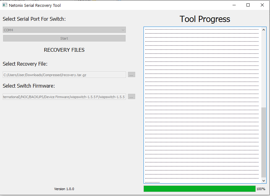

Tried this on one of our switches. Been stuck on 'Begin transfer of recovery file .....
The .tar file is an archive not sure if that might have an effect on the process. When i unpack it, i get two files mtd and switch. My conclusion, either the switch is proper faulty or an issue with the .tar file.
