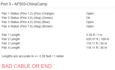

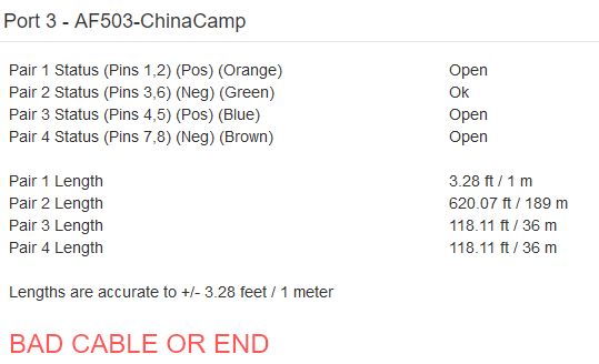

Lost an access point this evening. Its a AF-Rocket radio, running 48VH. When I send power to the radio I see the normal wattage indicating it is powered and running properly. But the links remains down. Cable test results don't make any sense:

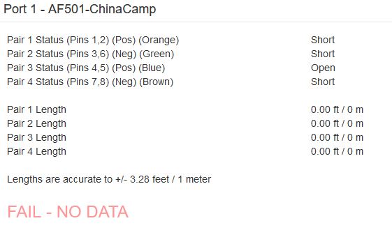

This morning another one on the same switch went down:

Went to the site, found the ethernet cable in port 1 was filled with water, and dripping onto port 3 as well.

unwired wrote:Went to the site, found the ethernet cable in port 1 was filled with water, and dripping onto port 3 as well.
Ouch.. That sucks! If nothing else, the ETH-SP's at least give you a break in the line and would prevent that from happening (as long as you have the appropriate drip loops of course)
