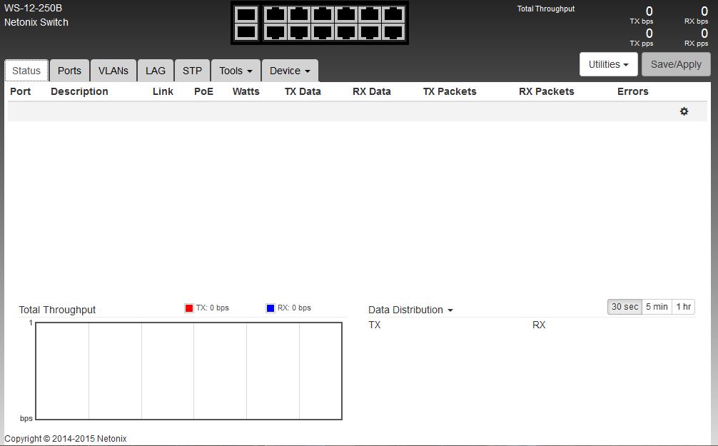

I upgraded to v1.1.3 earlier in the day and the GUI had structure, but no information. I upgraded to v1.1.4 and still have an incomplete GUI in Firefox, but Internet Explorer works fine. While in Firefox on the other tabs such as Ports, I can interact and change the values, but the Thoughput at the top just shows 0 (zeros).
I cleared the cookies and restarted Firefox, but this is what I get on the status tab.

Just to clarify, Firefox and SeaMonkey are both Mozilla browsers but with a different GUI. There is no browser called Mozilla but the Mozilla "Gecko" engine is shared by both, as well as Pale Moon, Waterfox and numerous other variants that are all just customized/optimized versions of Firefox and each of them share the same engine. If it works on one it should work on all, and vice versa. Unfortunately since v1.1.3 it's vice versa.

Safari and Firefox both appear to be broken with the UI
I will ask Eric to look at them as soon as he can.

We have tried Firefox v36.0.4 (32-bit), Pale Moon v25.3.1 (64-bit), SeaMonkey v2.33.1 (32-bit) all on 64-bit Win7, and Safari 6 on OS X, and Firefox v33.0 and v36.0.4 on Linux (Zorin). These browsers have been tried from multiple computers on our network. None work.
IE11 and Chrome v41 on Win7 and Win8 work with v1.1.4.
Anyone upgrading to v1.1.3 or v1.1.4 should not use a Mozilla-based or Safari browser to perform the operation. I think that should be added to the firmware notes. They work fine through v1.1.1. I do not know about v1.1.2.

Yea Eric is working on a v 1.1.5 that will fix Safari, and FireFox which we will post later today.
Also if people upgrade from a really OLD version say v1.0.10 to v1.1.3 and v1.1.4 it messes up the password and you are required to use a console cable to set the password as you can not login with a blank password or of course default the the switch. This was fixed in v1.1.5
UPDATE: v1.1.5 was posted which fixes Firefox & Safari as well as the password issue
