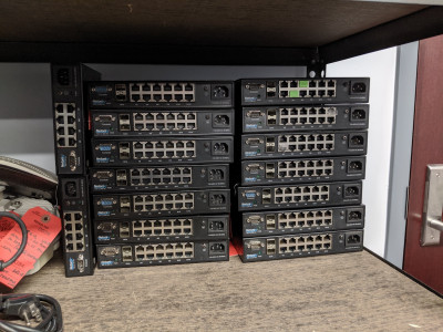

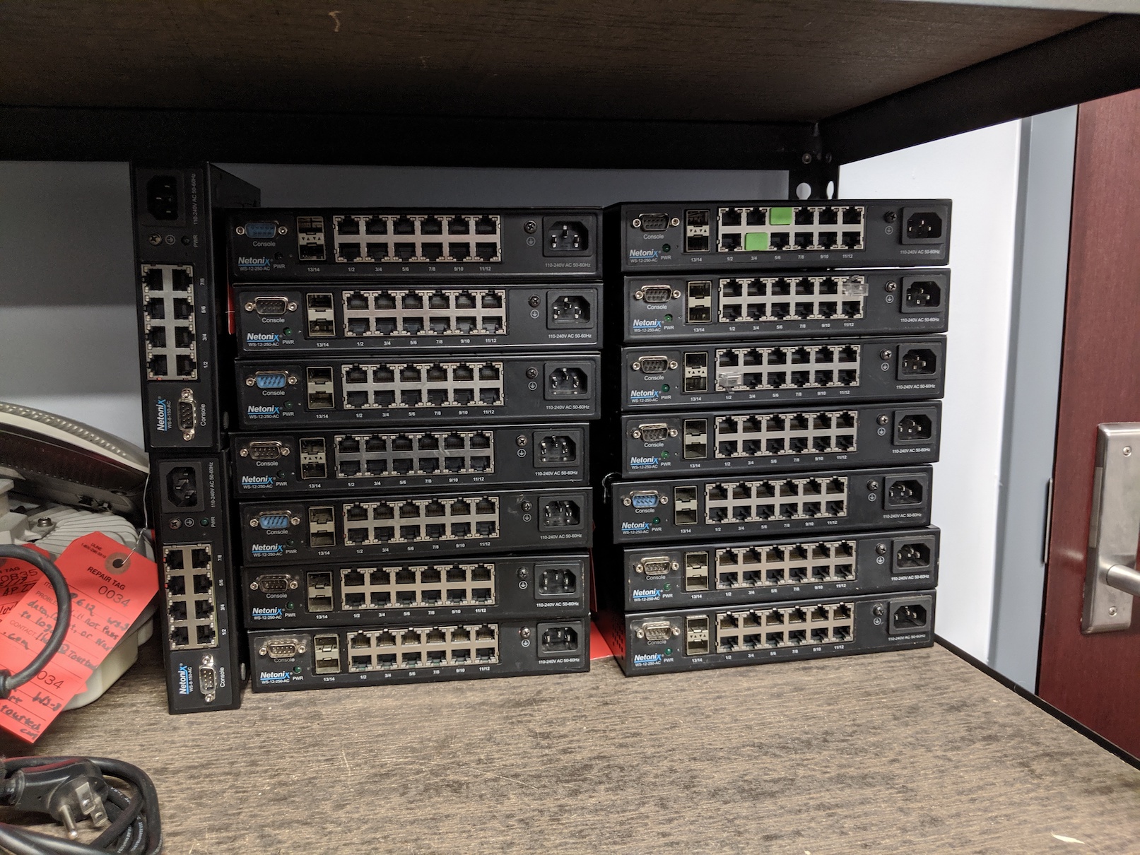

Additionally, my organization is wondering about what it might look like to purchase a block of 10 to 20 spare WS-12-250-AC boards and possibly 6-10 spare WS-8-AC boards. We have a bunch of boards that have 2-4 ports dead due to folks either mis-crimping cables and popping PoE and/or data on some ports or have had other issues that have the switches no longer powering on at all past the green LED. We'd love to be able to have a faster turn-around time by having myself repair the switches.
I'm more than capable of replacing the boards in the switches myself, but I simply don't have any available.
