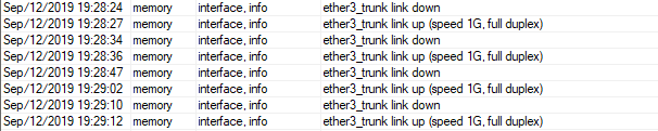

I just had a WS-8-150AC reboot on me and I am not sure why. Could it be failing or could it have crashed?
The switch is averaging 40-50Watts and is powering 5 RocketAC APs. It looks like before the switch rebooted that it was port flapping as my tower router log shows the link going up and down several times before the switch and all the APs on it rebooted.
This switch has been installed for around 2 or more years and it connected to the router with a 2ft premade ethernet cable. Neither the tower router or an Airfiber5X or Powerbeam5AC that are on the site but not connected or powered by the switch rebooted.
