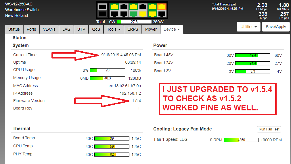

Hi,
ntp issue is not resolved in 1.5.4 for ws 12-250-dc and ws 8-150-dc after firmware upgrade it is still showing that you have not set time.
Tried NTP server in local network and public ,same result.
Re: v1.5.4 Bug Reports and Comments
TheNet wrote:Hi,
NTP service would be the same regardless of the model as they are all basically the same hardware and firmware just different number of ports.
I am not aware of any bugs with NTP on our switches. If you are having issues getting time from an NTP server it has to be your configuration.
So I just upgraded the switch here in the office to v1.5.4 from v1.5.2 and NTP worked fine in v1.5.2
Now this switch is behind a NAT but I have other switches in my WISP and even 1 at a VALID IP and others on invalid 172.17.X.X addresses that are not rout able beyond my network edge but they do route and talk to an NTP server we setup in our NOC inside our network.
And as I said all our switches use the same firmware and all our switches use basically the exact same internal hardware and basic design so this is not model specific.
NTP works, if it does not work then you need to look into your network configuration.
OK so NTP not working with DHCP IP address, will test this and if broken will have fixed and put in next release as programers are here in PA this week.
