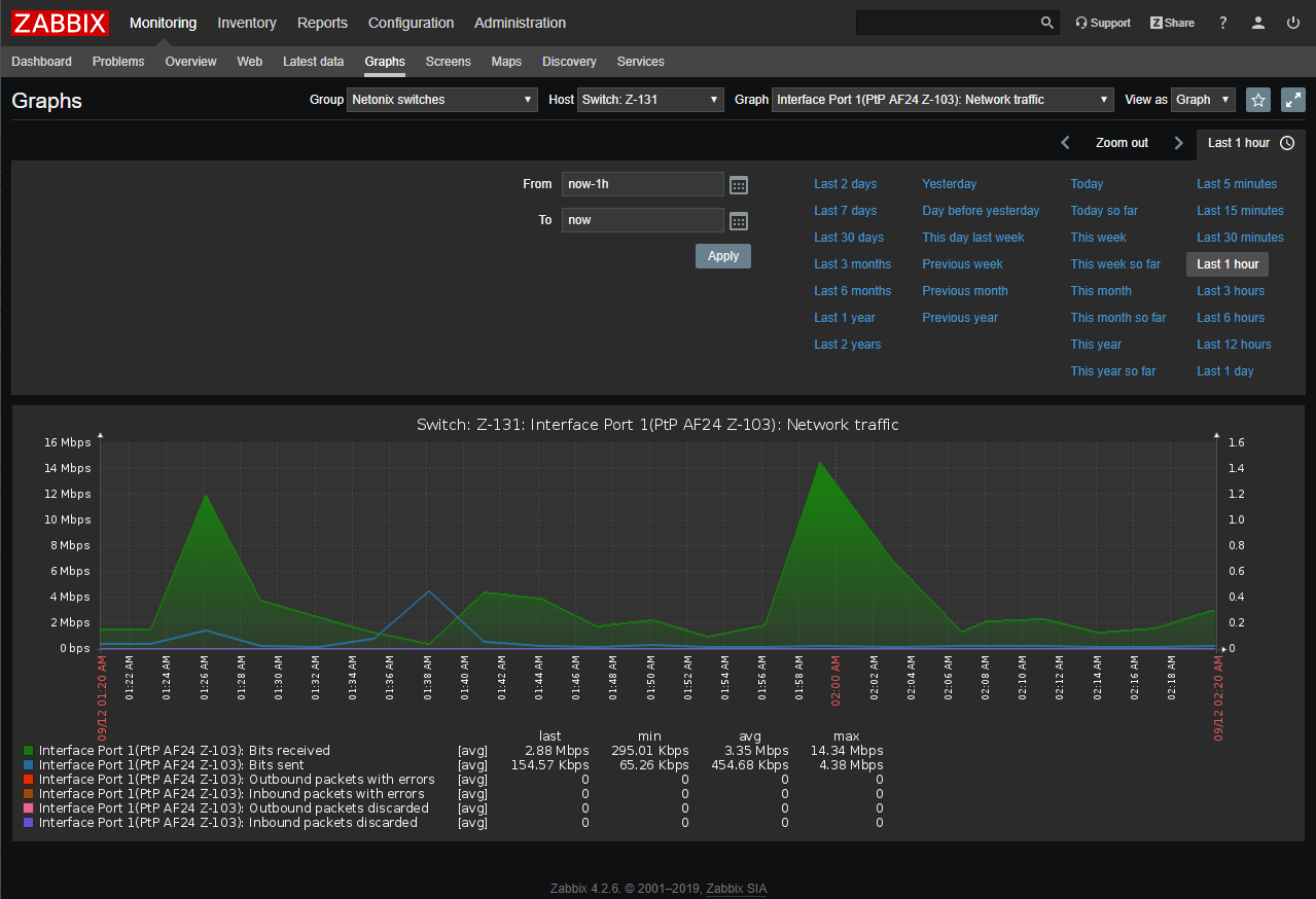

I would like too see the graph of the traffic on the interfaces.

Re: Zabbix Template
This is what I see:

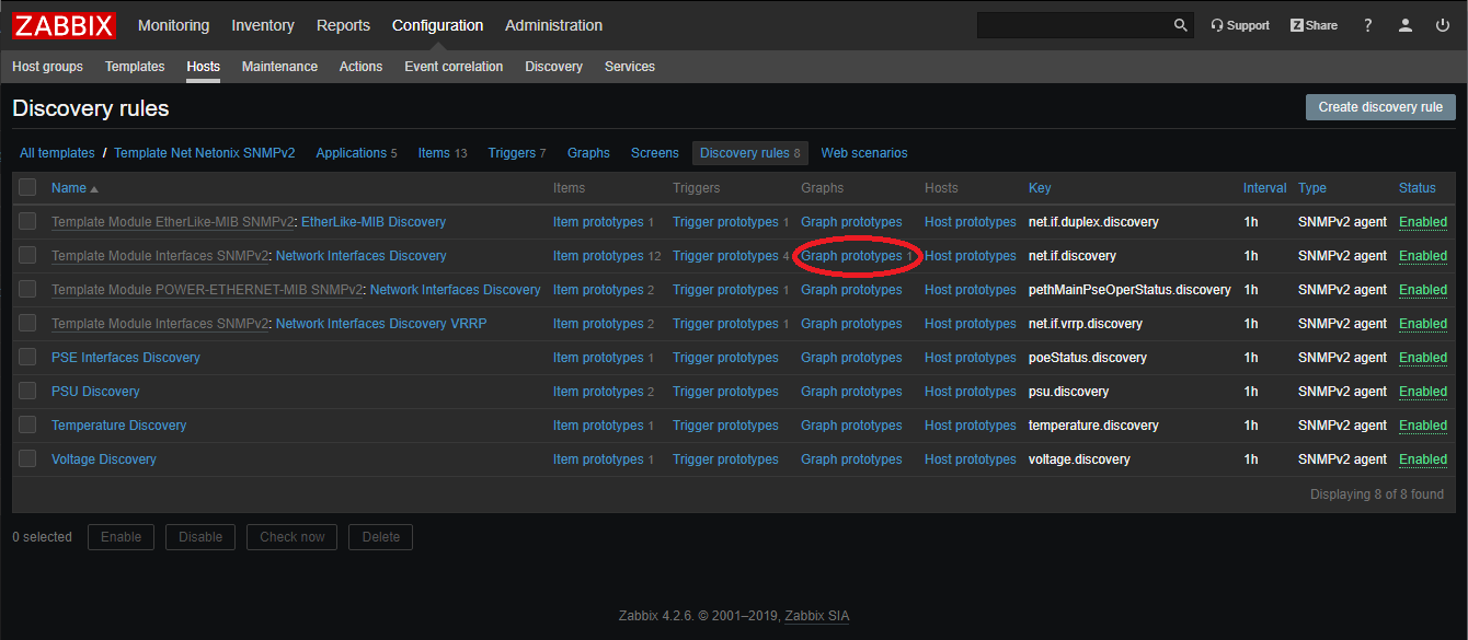

Do you have this in the Netonix Template Discovery?

Re: Zabbix Template
yes i have but they don't create graph.
