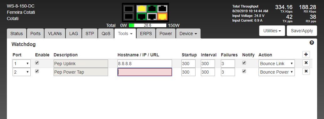

sorry for the super late reply on this, I am setting up a new deployment now and I have a screenshot to share for you of the WS-8-150-DC running firmware 1.5.3rc1
Im at the watchdog setup page here and I cant see a way to ping port 1 but bounce port 2 if need be.
edit: if I put a ping target on port 2 I'm afraid it will always fail on that port and constantly bounce power (port 2 is just a power tap there is no data flow there)

Re: Watchdog port bounce more than 1 port?
I think that there is still a misunderstanding of how the setup works.
In your configuration on the above pic you can place the hostname/IP/URL of a device that is plugged in via port 1 while the Port column is set to 2.
When the switch initiate's it's regular ping, it doesn't look at the port, so it doesn't matter which interface the device your pinging is on.
Ahh gotcha, that makes sense then, for some reason I thought if you wanted to port bounce 2 you had to ping something FROM port 2..... what you said makes more sense, Thank you for that
