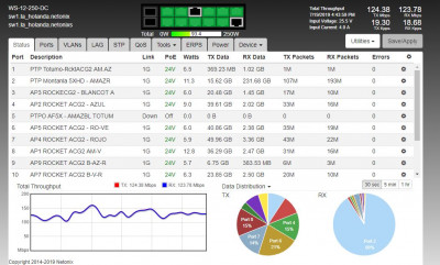

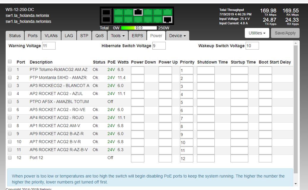

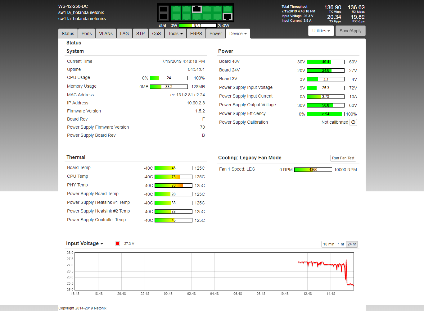

Hi,
- The switch is not rebooting since we connected it directly to the batts.
- The radios are all rebooting at the same time.
Status, power and devis status attached
Thanks!
Thanks!
