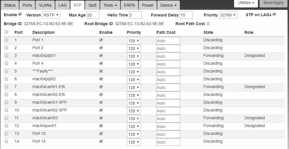

hey all,
I've found a WS-12-250-AC on our clients network that isn't seeing the Root Bridge on the network and all other Netonix switches are seeing the Root Bridge
- i've checked the networking (VLANs) and all are correct
- This switch is seeing itself as the root bridge so it's not electing the "Root" port
we are running 1.5.2 firmware
thanks
Justin

Re: RSTP no seeing the Root Bridge
Thu Jul 11, 2019 10:04 pm
A shema would help.
Is stp érable on port facing this switch?

mike99 wrote:A shema would help.
justinc@redfoxcorp.com.au
Posts: 10
Joined: Thu Aug 04, 2016 9:15 pm
Thu Jul 11, 2019 10:31 pm
yes STP is enabled
Fri Jul 12, 2019 12:54 pm
Same firmware and STP version on all switch ?
Is the link done via wireless ? The link could be the cause. Is WDS enable on it ?

mike99 wrote:Same firmware and STP version on all switch ?
yes same firmware and STP on all switches in path
yes it is a wireless link, there is no WDS option in UBNT AirOSv8
