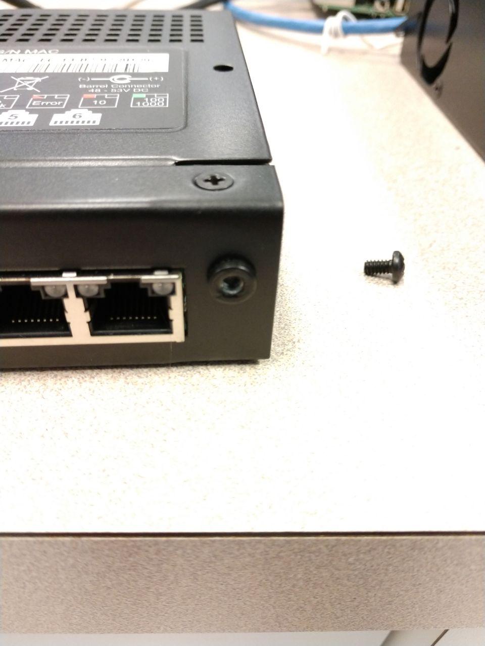

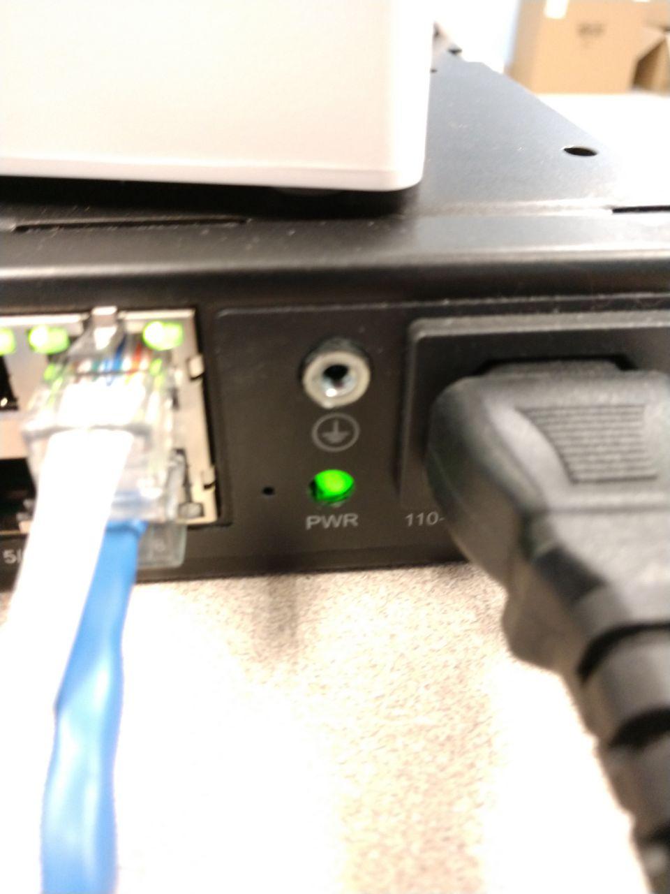

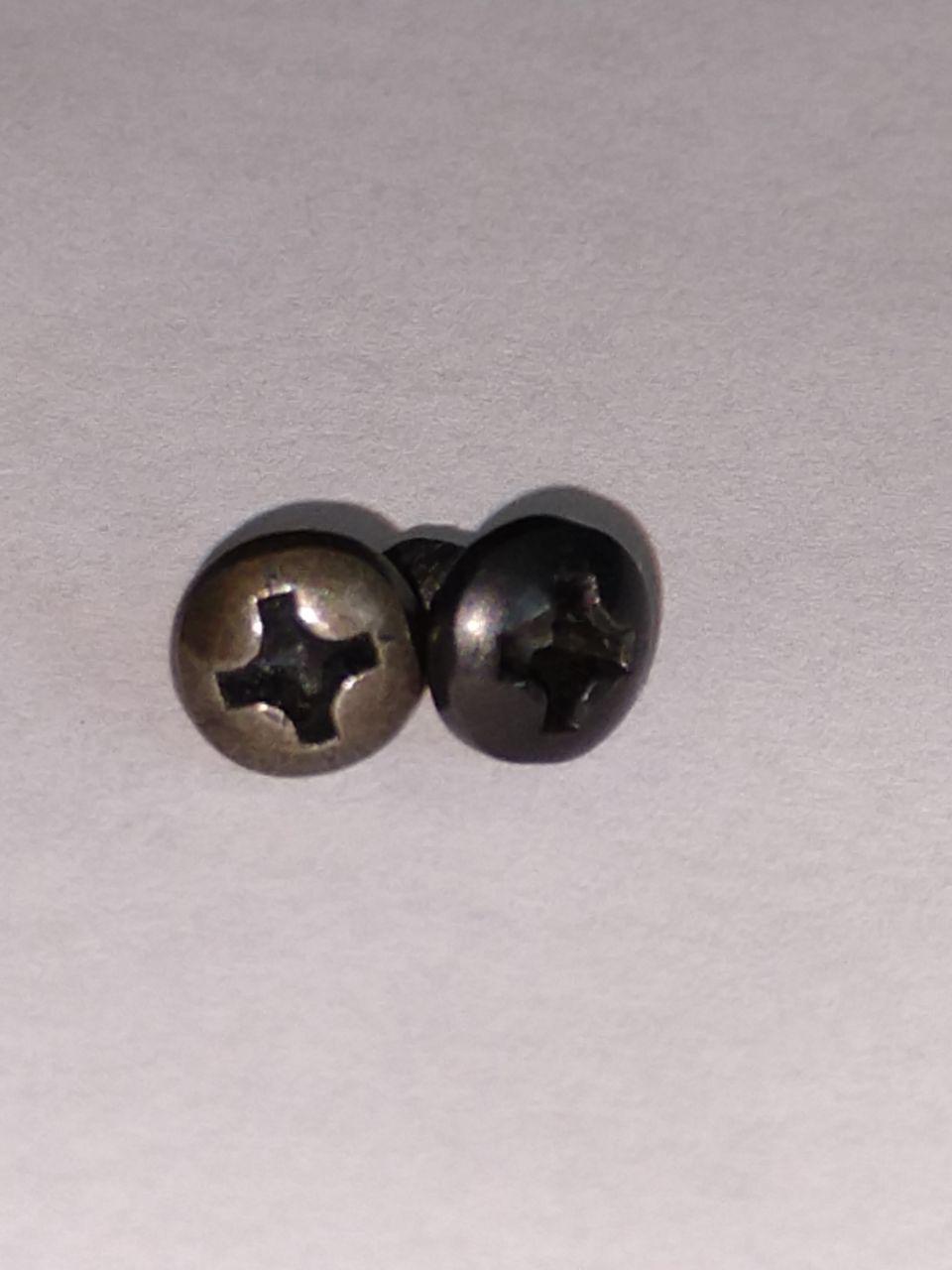

I just lost a switch after a storm and after closer inspection, I noticed the ground lug was painted over.
Looking at older switches the ground lug is clean.
OLDER
NEWER
Ground Lug on new switches

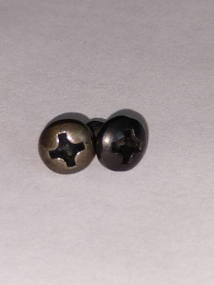

dray wrote:I just lost a switch after a storm and after closer inspection, I noticed the ground lug was painted over.
OLDER
NEWER

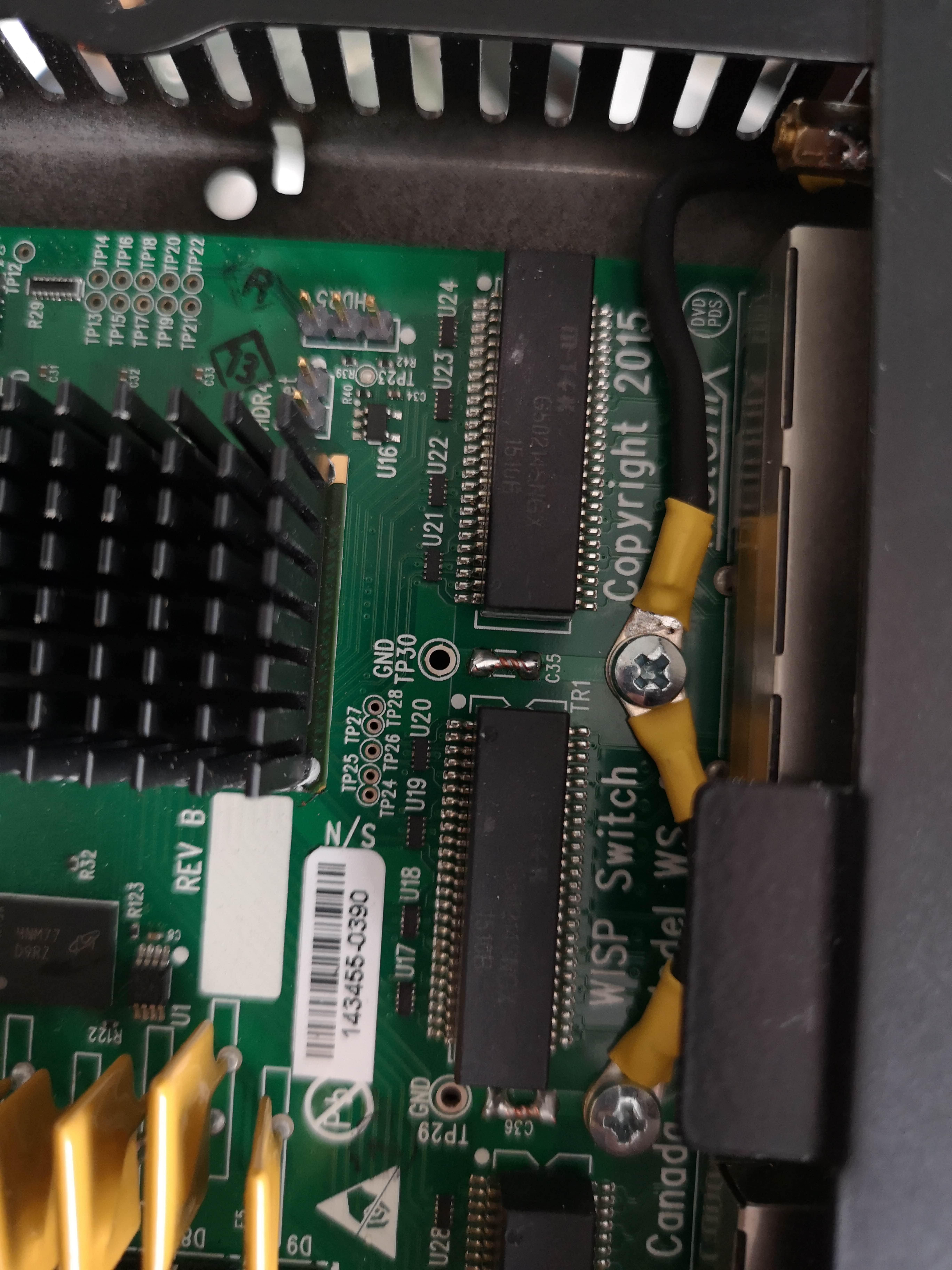

WS6 Low Ohm Ground mod
please see the picture

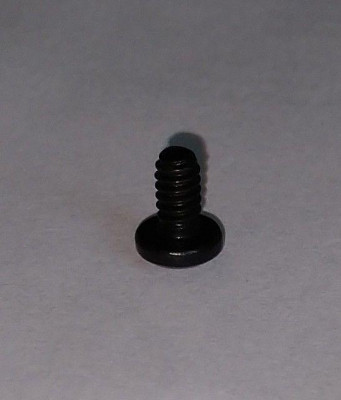

Looking at the older screws and new screws, they look like the have more of a coating on them also. I just tested with a multimeter and there is no connectivity through the black paint on the lug, and poor to no connectivity through different parts of the screw. Touching the silver threads inside resulted in good contact.
Re: Ground Lug on new switches

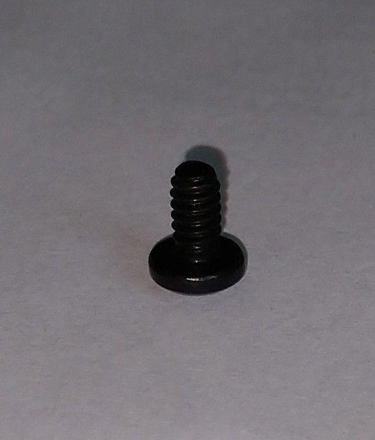

They are black anodized screws, they are completely conductive. I just tested them again to make sure I am not insane.

Chris,
Not arguing with you, just FYI just in case they changed something on you that you are not aware of.
New screws are different. Checking the bottom of the heads where the contact would be made, older ones are 0 ohms. New ones have ohms all over the place. They are darker and the coating or whatever it is, is thicker.
I would suggest everyone clean these contact points with a Dremel, or do the mod above.
