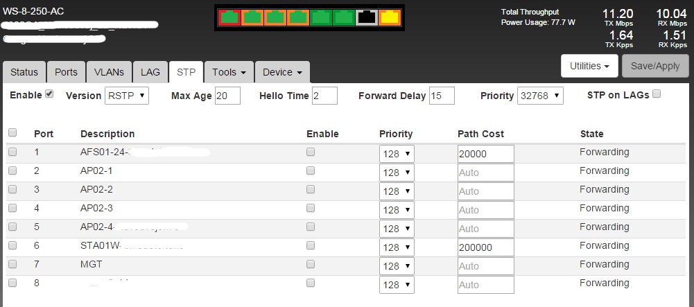

Re: WS-8-250-AC RSTP issue
Hi Chris
I need some help to identify what settings i need to do on WS-8-250-AC to get my redundant link working with RSTP.
Switch firmware is now 1.1.3.
Setup is link comming from EdgeSwitch24 port 1- throu AirFiber24 cost 20000 to netonix port 1, redundant link from EdgeSwitch24 port 2 - NBM5-400 cost 20000 (to force cost as 100mbit link) to netonix port 6
I have disabled "Loop Protection" on Netonix
This was all the settings i did on ToughSwitch8 to get it working, but on netonix i get loop on the network.
Are there something more i need to set?

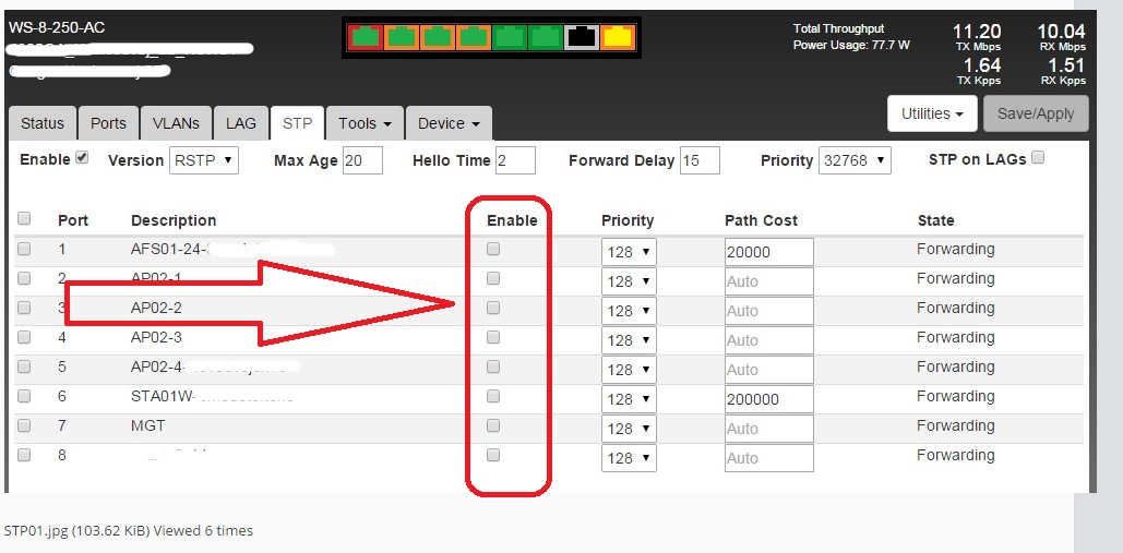

It might also help if you actually enable RSTP on each port
Thanks, i have upgradet all switch to 1.1.4
I have locket all lan port to fixed speed, instead of Auto, and havent had any link issues after reboot, issues since.
It simse to work now, but shudent State change to "Blocked" on the backup link? both ports says "Forwarding"?
Hightech wrote:Thanks, i have upgradet all switch to 1.1.4
I would use Auto instead of hardcoding speed/duplex as this can cause packet loss and disables any Flow Control as Flow Control only works on Auto sensing ports with any switch not just us, that is the standard.
If you have 2 switches both using RSTP connected together by 2 cables then ONE switch will elect to be the one that actually changes a port status to Blocking not both switches.
