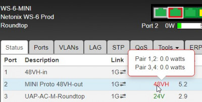

Sun Apr 21, 2019 6:59 pm

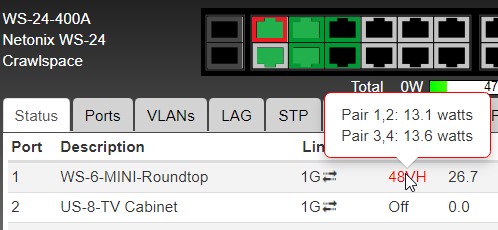

I was testing a new Ideal crimper on a cable I strung between two MINIs and I wanted to make sure the crimp was making a good connection so that current draw was equal across all pairs. When I mouse over the port, it shows 0.0 on all pairs. The other ports doing 24V show which pairs and the watts. As a sanity check, I tried the same on the WS-24 and it shows the per-port numbers.

Hello lligetfa,
I worked on this for quite some time. I believe I have found an area in the code which may explain the issue, however, after having several ws-6's sent to me from the factory, I was unable to replicate the problem. I suspect that you are working with an older board rev then what is available now.
To confirm, could you check the status page and tell me the board rev version?
If it is before F, then I do not have the means to reproduce this locally. If you are willing, I could send you a test firmware so that you can test to see if issue is resolved, if you are able to confirm then I will add it into the next rc release. But of course first we need to know if you are using a different board rev.
Re: No per-pair watts on MINI
Mon May 13, 2019 7:09 pm
Board rev D.
Stephen
Posts: 1077
Has thanked: 105 times
Been thanked: 208 times
Tue May 14, 2019 12:14 pm
OK looks like that's the issue.
Can I PM you some firmware to test?
Tue May 14, 2019 3:53 pm
Yes, PM or email me the test fw.
Tue May 14, 2019 8:02 pm
Test firmware did the trick.
Stephen
Posts: 1077
Wed May 15, 2019 1:10 pm
Thank Illigetfa,
That change will be on 1.5.3rc2
