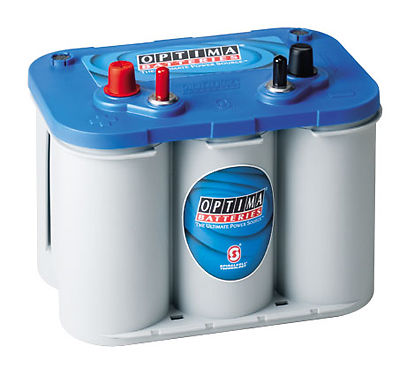

I use these batteries:
http://www.ebay.com/itm/Optima-SC34DM-B ... 6b&vxp=mtr
