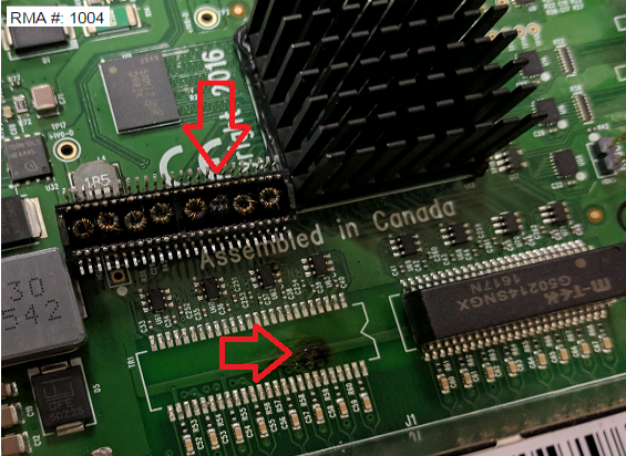

Re: WS-12-250DC not switching on anymore
If the SOC is fried we do not replace that, it cost more in labor then it is worth, we replace the whole board.
However your SOC may not be fried possibly your 24V power supply is the issue which "sometimes" can be fixed.

If we replace a board in RMA we charge $175.00 (Cheaper than buying board but you have to weigh in shipping I guess)
Most common cause for damage to our switches and all WISP gear is ground current.
