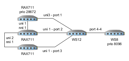

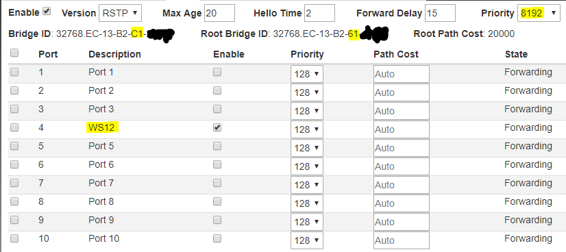

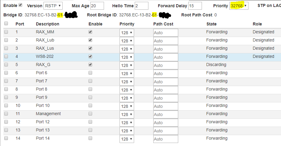

STP priority of other devices is ignored.
The current behavior of the Netonix switch is to choose the switch only based on MAC address (lowest mac = root switch) while priority should come first in root electection process and take mac address into account only if the're a priority conflict.
Netonix switch STP behavior reverse to the standard by electing root based only on mac address and ignoring the device priority.
Exemple:
switch 1 as a default priority of 32768 and mac address EC-13-B2--61-xx-xx
switch 2 as a priority of 8096 and mac address EC-13-B2-C1-xx-xx
Switch 2 should win root election since priority is lower but switch 1 win election since mac address is lower.
Also, on switch 2, Priority is 8192 but switch still show bridge ID 32768.ma.c.a.dd.re.ss like if priority was still 32768.
I was first thinking it was a priority problem in the netonix, that the priority change is estetic only and don't affect vitesse core config but it's more than that.
Even other brand priority is not respected. I tryed a setup with 3 Raisecom RAX711 and the STP priority of those device is also not respected by the netonix. RAX no 1 have a priority of 28672 and the 2 other RAX elect it as root switch but the WS12 with priority of 32768 elect itself as root switch since it own mac address is lower, completely ignoring the RAX priority.
The connections setup and both netonix STP config are in attachments.
Here the 3 RAX STP output

P.S. : None specified priority on schema = default priority of 32768.

I just saw that mac of the raisecom device is lower than netonix. It's even stanger then since I really can figure how it elected itself as root then.
Re: v1.5.2 Bug Reports and Comments
Hi gang,
STP seem to be working fine. Forget the bug report. It was a dawn Mikrotik RJ45 SFP stick that was the problem. The RJ45 side was negociating ok with the netonix but the SFP side connected to the RAX was down. I didn't check this out in the CLI since the port was up on the netonix and the stp CLI command didn't show that the port was down. I change for a working SFP (Robofiber instead of the Mikrotik) and the Netonix behavior just fine.
The second Netonix switch was on a older firmware and since I was seeing similar problem, I didn't test with both at last firmware.
My bad. I'm sorry for the time Stephen loose on this.
