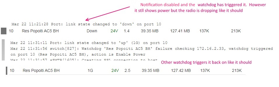

Hi,
Not sure if this is a bug with 1.5.1 or issue with this brand new netonix WS-12-250DC.
Port power watchdog is working but when it disables the port it's still showing voltage going through. The radio is down (not showing connected at other end) and reconnects when the watchdog kicks in.

I'm seeing this on 1.50 and 1.52 as well and also on WS-8-150-DC

Re: 1.5.1 Wattage shown on disabled port
Mon Apr 15, 2019 1:05 pm
Fixed in testing - will be on the next release.
Fri Apr 26, 2019 7:12 pm
It's not going to be removed. It's just being repaired. There was an issue in calculating the timing in certain circumstance's.
Tue May 07, 2019 6:14 pm
Ludvik wrote:I'm use this feature for secondary power for routerboards! Please keep this option.
We have crossed wires. It's not the PORT being disabled. It's the POWER being disabled in the watchdog. Therefore it shouldn't be showing any voltage.
