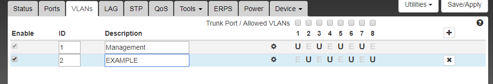

Then Fine below is an 8 port switch broken into 2 logical switches
Ports 1,3,5,7 one logical switch
Ports 2,4,6,8 another logical switch
Ports 1,3,5,7 can not talk to 2,4,6,8
Catch 22: You can only access the switch UI/CLI on Ports 1,3,5,7 as they are the only ports present in the Management VLAN 1
viewtopic.php?f=6&t=2589&p=18225&hilit=QinQ#p18225
