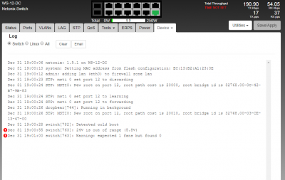

I recently purchased a WS-12-DC and used it only for testing and configuration. But after three days of testing where he was always on one morning I found these errors in the log.
I tried the reset and also new firmware, but had no benefit.
What can I do? Do I have to ship for RMA?

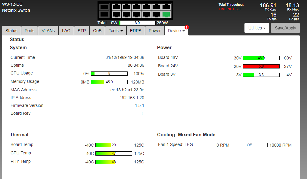

Board 24V and fan error.
Re: Board 24V and fan error.
This would indicate the 24V power supply is either damaged or failed, this is nothing software can fix.
Sorry, you would need to RMA the unit.
