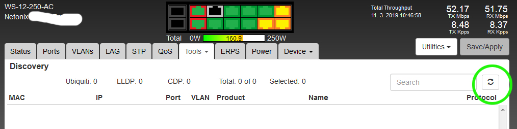

Re: v1.5.2rcX Bug reports and comments
There is long time ongoing issue with Discovery tab page - the refresh buton kick me back to the main page (latest Firefox 65.0.2 64bit). If I test the same in Chrome, looks like works as expected.
