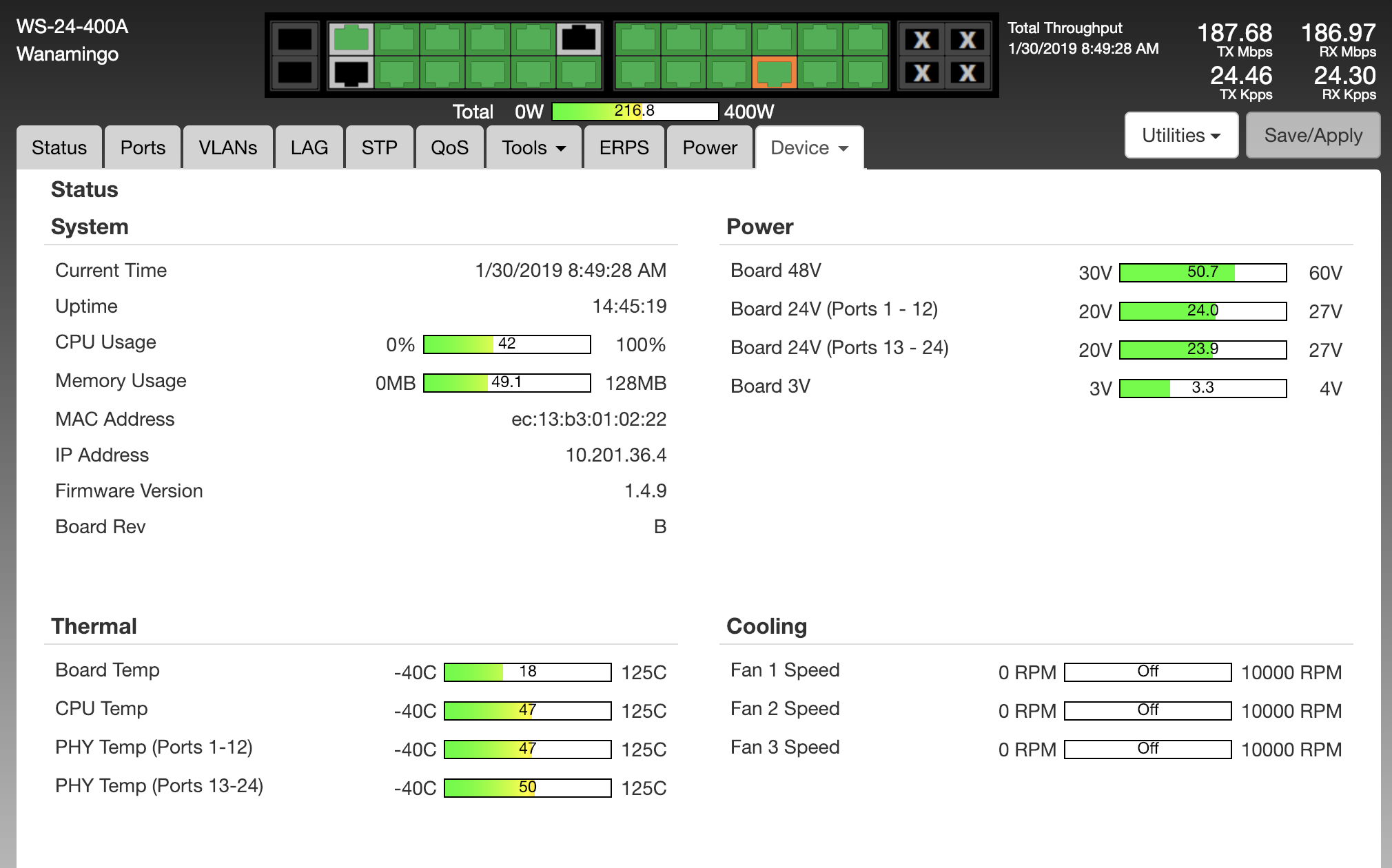

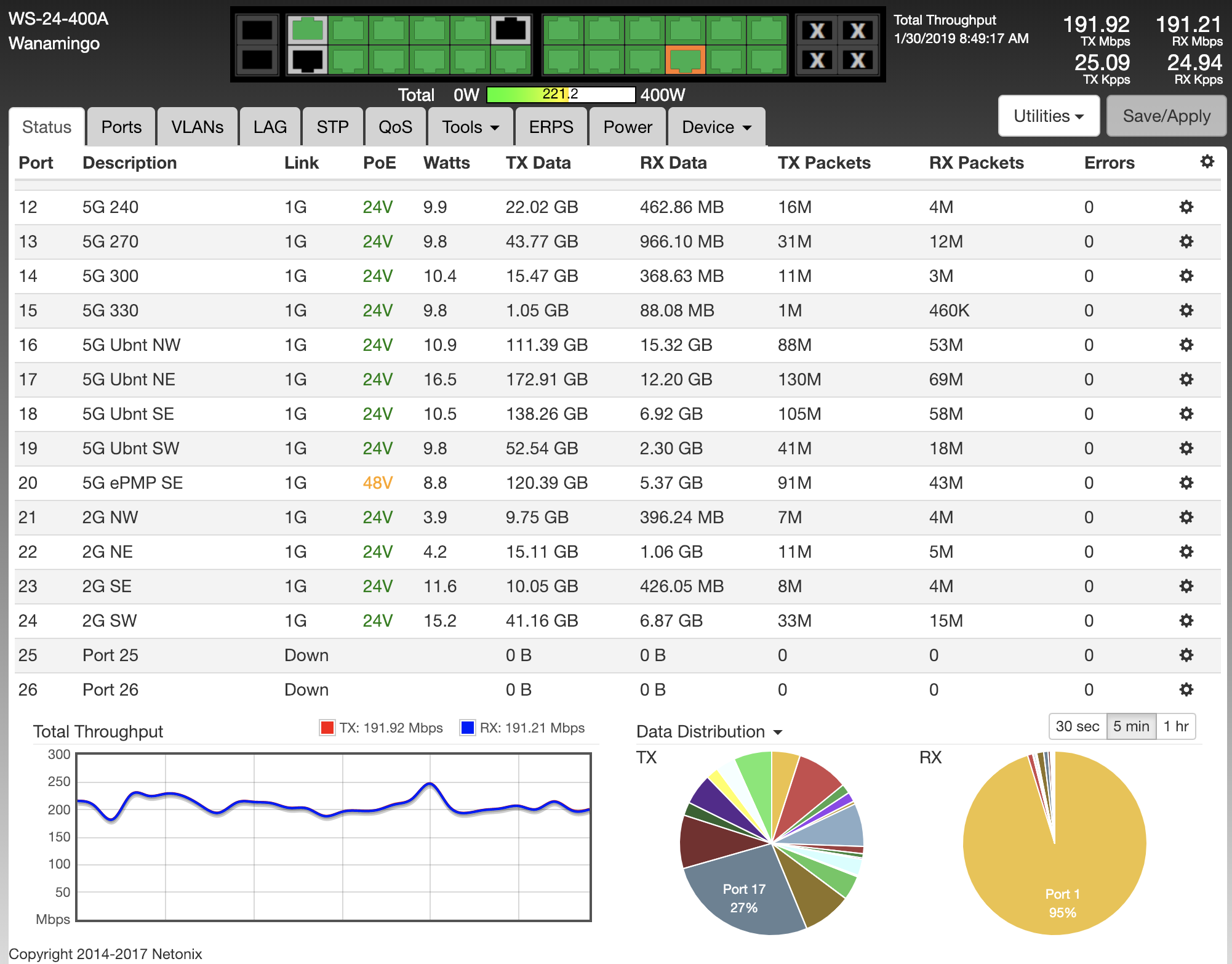

Please post up a screen grab of the Status and Device/Status TAB.
But "possibly" could be this issue if the switch is close to 2 years old or older and you added more 24V radios to the switch recently: viewtopic.php?f=17&t=3934#p24989

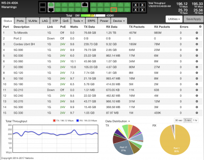

Here are the screens. I have not added anything to the switch for around 1 year. If it is the power issue could the cold be exposing the problem (the switch components are working harder)?

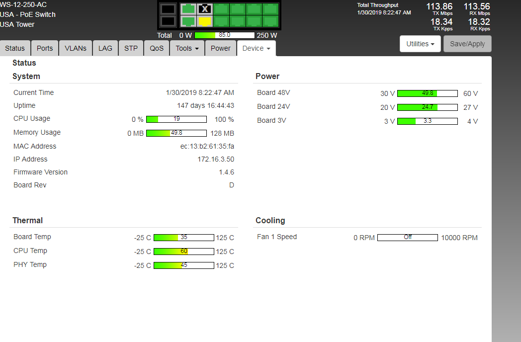

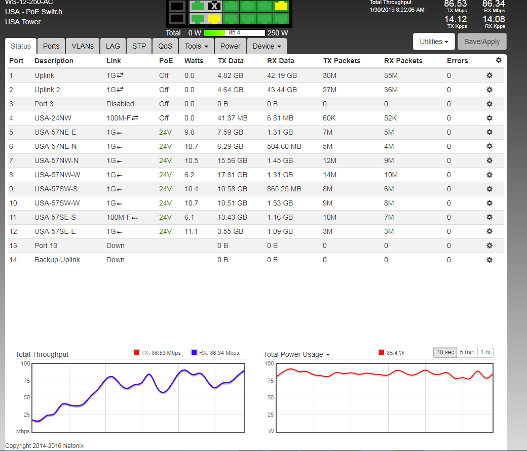

Also this switch and my one spare were mfg in 2015.
Re: WS-12-250AC - Having issues in subzero weather?
Yea this unit definitely has the original design of 108 watts of 24V POE budget.
You can RMA them for the upgrade.
We would install 24V MOD, GROUND MOD, and do a full checkup for $50.00.
I am guessing that the extreme cold is either a coincidence or your radios are simply transmitting more which requires more power which makes sense since it is so cold kids are inside as well as adults so you have increased traffic.
Also that firmware v1.4.6 is really really old, not your problem, just complaining.

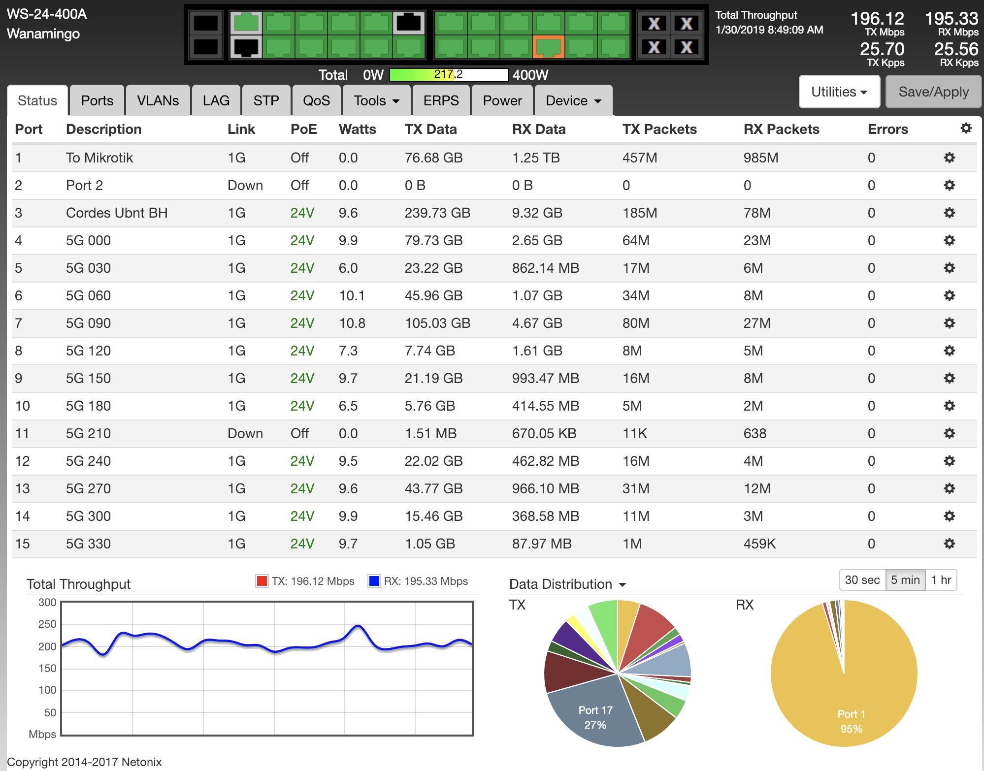

This is not one port going down, it's ports 3-12 going down at the same time so it's not a matter of a loose cable not plugged in right. It only has happened during this cold and only on the 1-12 port bank of the 24 port. Logs show this bank having trouble together at the same time.
