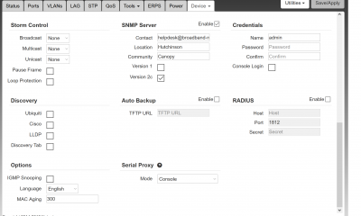

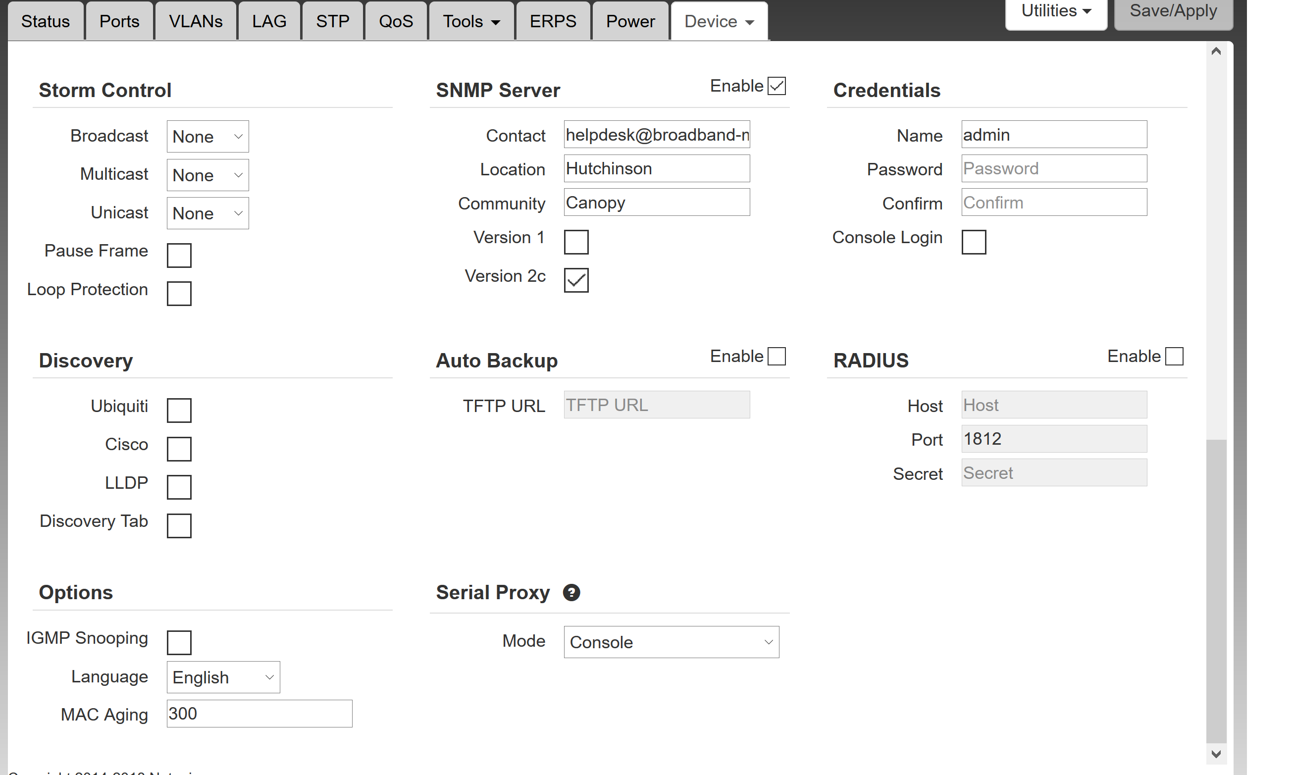

Limit would be set under storm control but then you say you did not set any limit. Another guess is that discovery is enabled on the switch and contributing to an already problematic broadcast issue. If not that, then my next guess is pause control. After that, I'm out of guesses.
- anthonyw
- Posts: 6
- Joined: Wed May 10, 2017 1:47 pm
Re: DHCP - fail only difference is Netonix switch
I'm sorry, attached is the setting tab so you can stop guessing :) .
All of that is shut off as is flow control, MS and DS on the ports tab.
