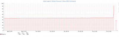

So I have a very busy core site that the Netonix switch there keeps rebooting every few weeks. It's a 24 port that is pretty heavily utilized on port density and throughput. The switch that was there died a few weeks ago and I replaced it. The new switch is doing the same thing.
I've verified the site is not loosing power. The switch appears to be exhausting memory moments before the crash. Why is this happening and how do I prevent it from happening?
Netonix Keeps Rebooting on 1.5.0

I turned off the discovery tab.... all discovery protocols were already disabled.
If you look at the graph, this was a sudden memory increase, not something that crep up slowly over time. As of this morning, it's still down low.

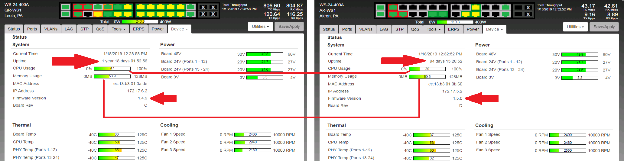

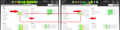

Its hard to fix or even know what an issue is unless you know what it is. As you can see in the pictures below none of my switches are seeing this?
