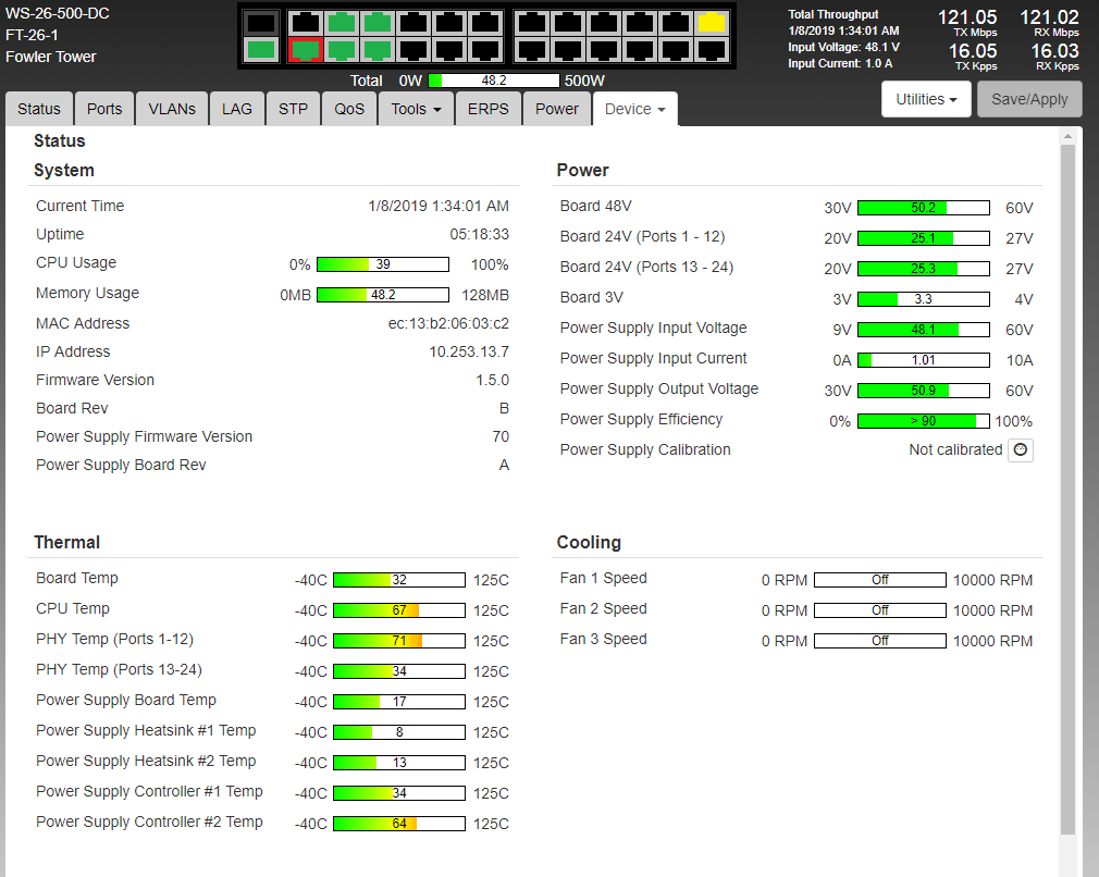

I have a switch that is having issues. It is recently deployed (last 2 months). I am not sure on the age of the switch as it has been on my shelf for a while. I have it powering one radio, the rest of the devices connected to it are powered separately (on their own fused feeds off of the same power supply). The only device going down is the switch, most recently last night. I think I am going to need to RMA the unit.
Here is the log...

Re: WS-26-500-DC Power Issues
Please RMA the unit
