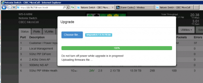

I was attempting to upgrade my switch, but it gets to this point (see attachment) and fails to go further, it just sits here indefinitely.
Now I'm extremely nervous about rebooting it. Am I going to be OK, or should I expect a truck roll? Please advise.

The switch just takes me back to either a login or to a main page, the software has not updated. I don't have any more details to show other than the screenshot of the switch taking the firmware, but no other output. Is it safe to reboot the switch remotely or no?
