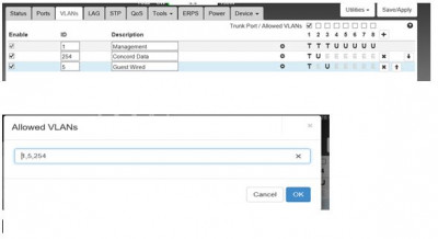

All you should need is this, you do not need to use allowed VLAN list.
CLICK IMAGE TO VIEW
Un-Tagged packets entering port 2 would exit Port 1 encapsulated with VLAN ID 254
Encapsulated packets with VLAN ID 254 entering port 1 would exit Port 2 Un-Tagged
Un-Tagged packets entering port 3 would exit Port 1 encapsulated with VLAN ID 5
Encapsulated packets with VLAN ID 5 entering port 1 would exit Port 3 Un-Tagged
However you would not be able to access the switch UI from ports 1,2,3
You could but a U on VLAN 1 Port 1 and still access the UI/CLI from port 1 with Un-Tagged packets on port 1
You could but a T on VLAN 1 Port 1 and still access the UI/CLI from port 1 with Encapsulated packets with VLAN ID 1 on port 1
From here is gets more complicated and many combination.
You can also put a non route-able IP on VLAN 5 and 254 and access the UI/CLI via that IP.
Since I have no idea of your IP sub-netting and routing it gets difficult to predict what you want.
Again VLANs are handled pretty standard across all switches, this is not something unique to Netonix switches but is more rather an IT networking issue.

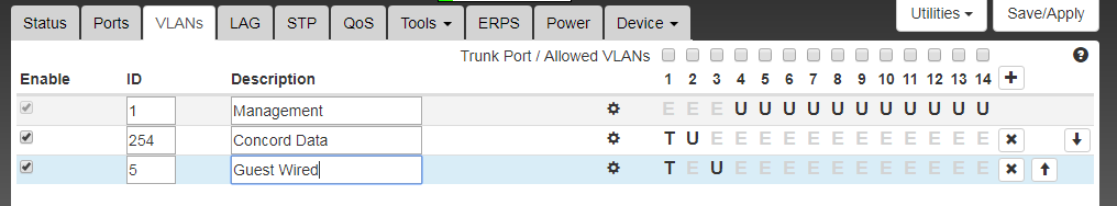

CLICK IMAGE TO VIEW

I have a Netonix WS-8-150.
Up to now I still forget how to set "U" on a port for a VLAN. I am always given T or E choices.
Please help.
Please help.
Re: VLAN simple question
You already have U or Q on an other VLAN of this port.
You can have a single U, or Q, by port.
