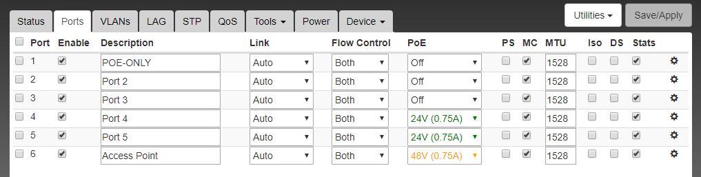

Having googled the symptoms there are a couple of old threads on the forum where people have had a similar issue and "Flow Control" is pretty much mentioned as being a potential issue on all.
I have checked our flow control settings on other switches and they are all set to "both", i have also checked a couple of the Mikrotik routers and Flow control is switched off. I know this will be the same everywhere based on using a std build.
My question is two part really, do you think flow control could be the issue and if so what settings should I be using. If not... any idea's ??
If configs will help i can jump onto a working switch and paste screenshots, based on past experiences even if i get to physically connect to a switch with issues i cant get on it anyway :-(

1) Upgrade your firmware - I would use v1.5.1rc8 but at least v1.5.0
2) Disable Flow Control on all ports
My guess is your experiencing a Packet Lock which has been discussed many times.
This is not a Netonix ISSUES but rather poor implementation of Flow Control. Keep in mind out switches use switch cores so "we - Netonix" do not write how Flow Control works. All we do is allow you to turn it ON or OFF. With radios Flow control is most often written by the vendor.
I would also suggest you get a console cable and make sure it works before you NEED it then you can console into the switch and look around before you reboot it. This means you should also practice using the console and or SLI so you know how to maneuver around and get what information you need.
My guess of a Packet lock could be figured out by NOT rebooting it but rather unplugging and replugging each cable one at a time when you from the port that has the packet lock traffic will resume.
You could also watch one of the switches that has been locking up and my guess is you would see Pause Frames stacking up on 1 or more ports.

rodrayner wrote:Does anything need doing on the router re Flow Control as its already disabled
Disable in switch on Ports TAB
rodrayner wrote:Do i disable flow control on every switch or just the one with the issue.
That's up to you. Look Flow Control is great except when it's not.
Step #1 Upgrade Firmware
Step #2 Disable Flow Control (I would start with the one with the most issues)
Step #3 Get a working Console cable and learn our CLI so when it happens you can gain access to switch and see what's going on without a reboot.
