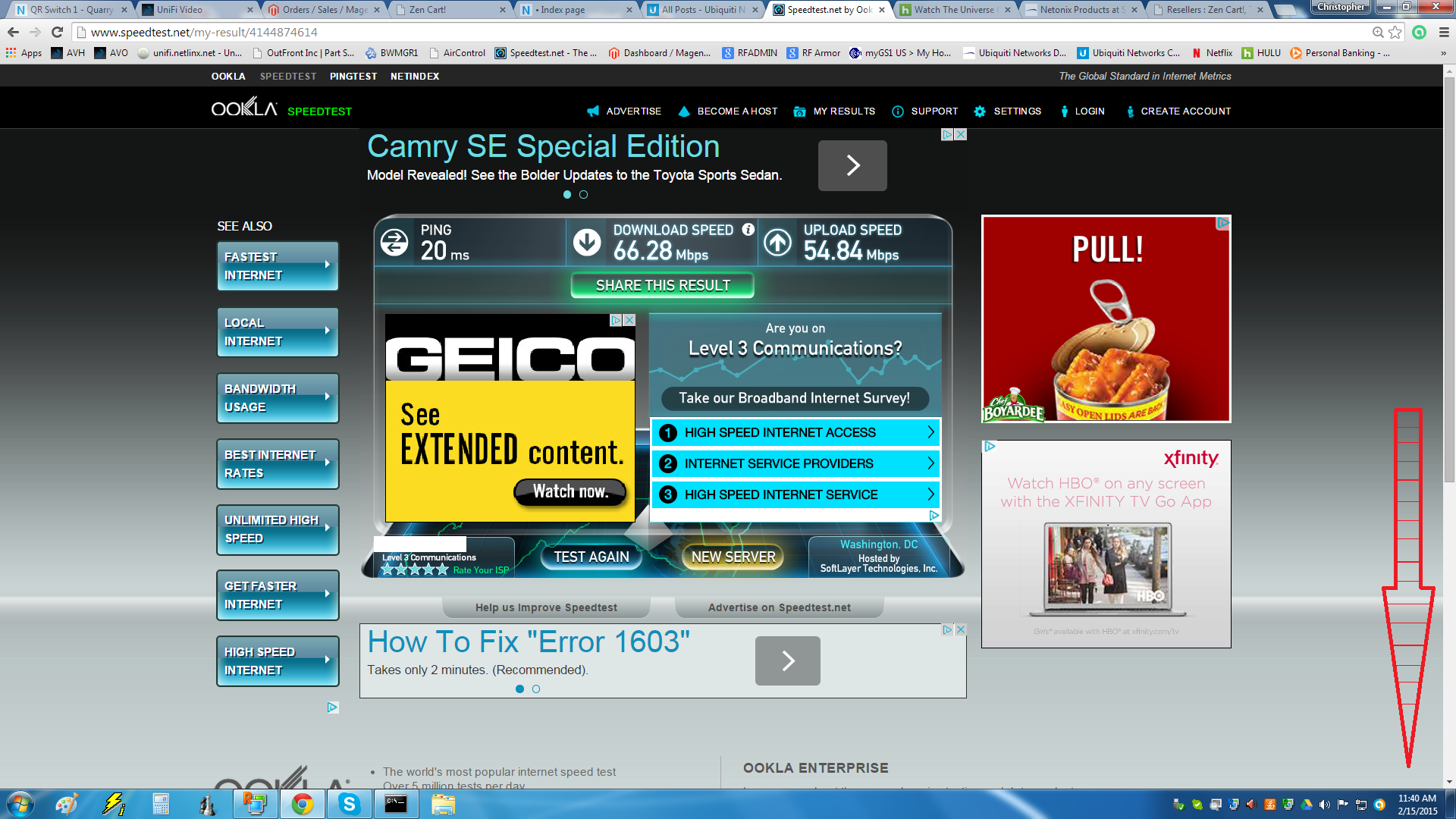

Sunday Speedtest
It is Sunday here and 11:42AM and we are in the middle of a DEEP FREEZE with single digit temperature and 50 Mph wind gusts so the kiddies are at home streaming and such and I still get this Speedtest.net here at home so I am pleased.
I am on a 30 MHz wide DFS sector that maxes out at late at night to 89+/- Mbps so this result right now is pretty good.

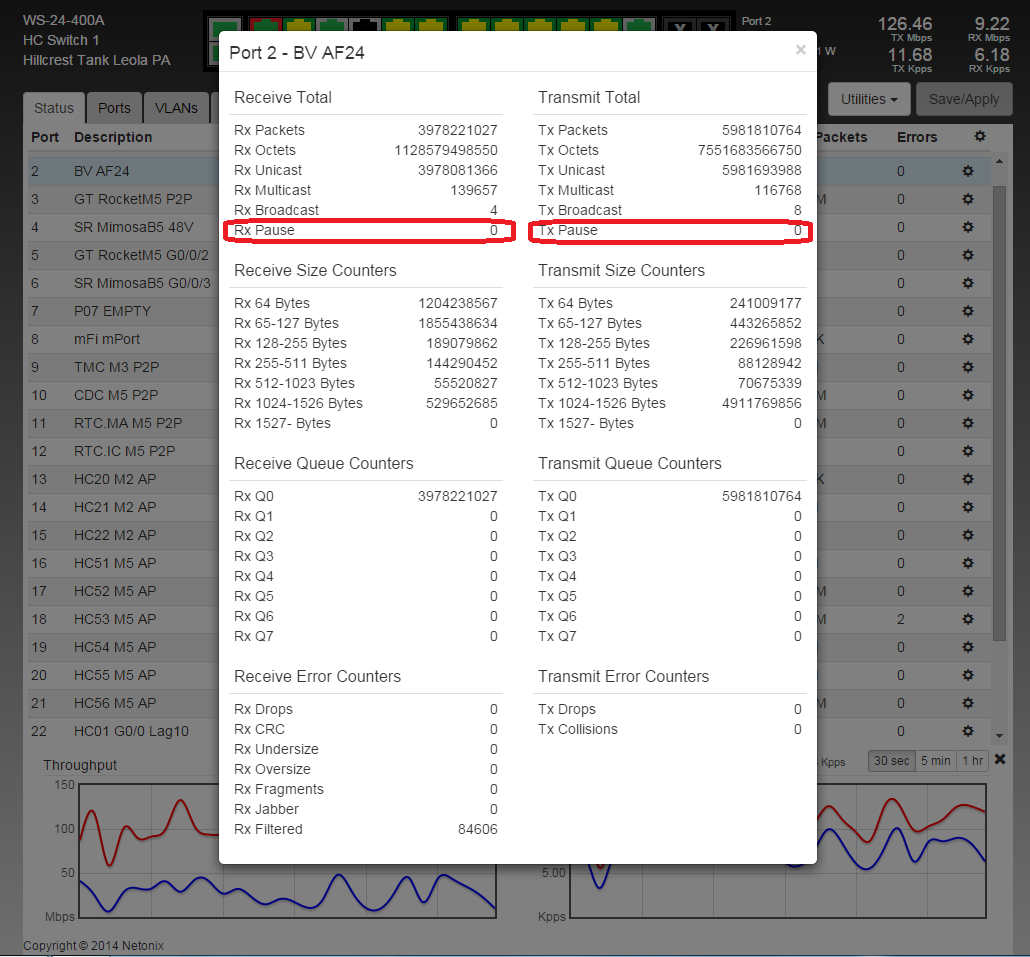

Re: Since I haven't received my first switch yet?
I just checked a couple of my switches aggregating 100Mb AP's to a single Gb port on the router. not a single port shows pause frames...
The only port I found pause frames on was a Exalt G2 11Ghz radio. The switch is acting like a mid-span.. there were only a few
does this mean I just don't push my AP's hard enough? or what?
Well now that's interesting that you're seeing pause frames going to the G2.... wonder what would be bottlenecking that?
Pause Frames work their way backwards to a point in the network that has the ability to to tell the sender to slow down which is normally the closest router to the AP. The router has the ability to tell the sender or the next destination back the line/route to slow down and so on all the way back to the original sender. The router will tell the next hop back to slow down with normal TCP/IP congestion mitigation NOT pause frames.
So Lets say you have a WISP Switch with 100M APs plugged into it and a 1G up-link from the router at the tower.
You will not see pause frames on the AP 100M interface but you will see Tx Pause Frames on the 1G interface talking to the router and the interface in the router will see Rx Pause Frames on the up-link interface.
Now if you run a flat network the pause frames may show up further back the line.
I hate Flow Control and the Pause Frames it generates but with the radio in Bridge mode and with the amount of packet buffers 100M ports have and not being a way point destination in the route it has no way to use TCP mitigation mechanisms to slow down individual streams so Flow Control is the ONLY answer. I hate Flow Control but it is the best and only option at this time so TURN IT ON!!!!!
Now our switch does use an advanced Flow Control with back pressure so it is better then most other standard Flow Control. - TURN IT ON
