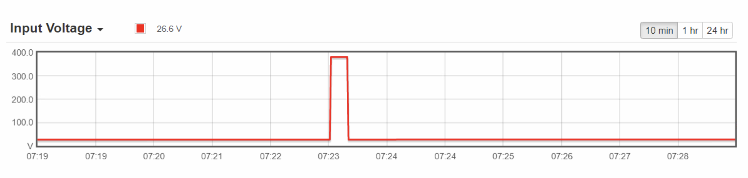

Occasional voltage spikes have appeared in the voltage plots but now it is happening more often and figure I better get to the bottom of this before we get too far into Winter. The spike is measured at 400 Volts, do not know how that can even happen?

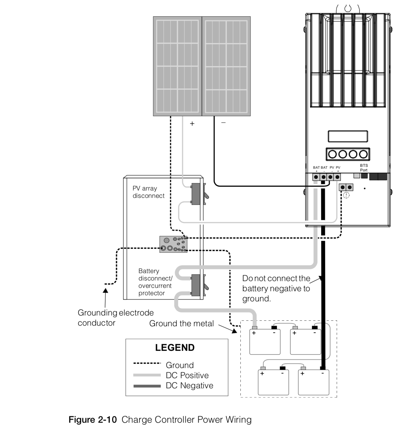

Is the switch connected DIRECTLY to the battery bank and not the controller and the charger/controller connected to the batteries separately?

Re: Voltage Spikes Unexplained

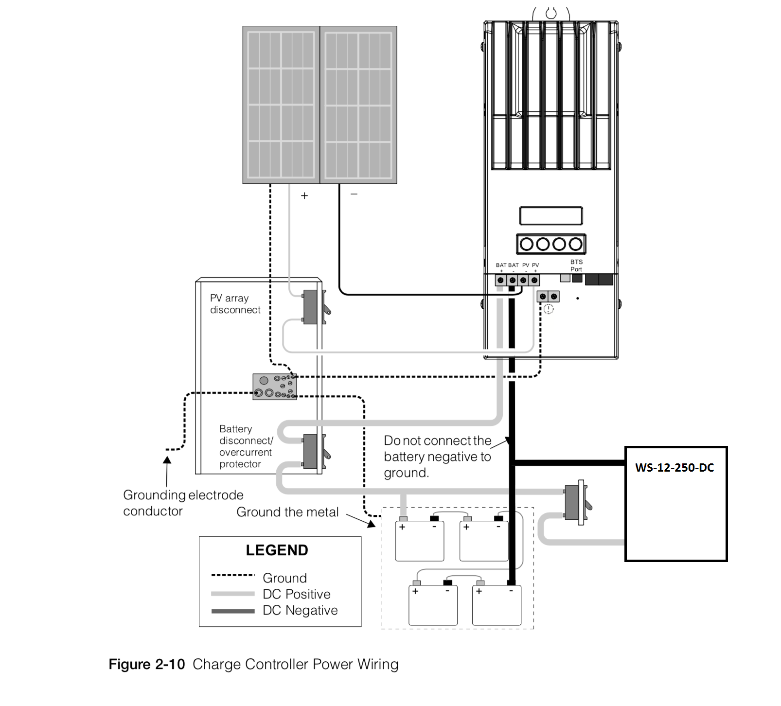

I do not see the switch in your diagram?
If the wires running from the switch do not go DIRECTLY to the battery bank (with a breaker) but rather connect to a terminal on the controller this is not directly connected to the batteries.

Thank You and understand. The switch is not in the diagram but is connected to the batteries, not the controller. And to be more accurate, it is not a breaker, we are using an inline fuse on the positive wire.
Do you think the switch is actually seeing 400 Volts and not failing? 400 Volts by far exceeds the maximum input voltage.

This is DIRECT connect, if not like this then it is WRONG.

I do not see how, 400 volts would obliterate the switch?
I do not know that the switch is failing, you could swap it out with a spare and see if the issue stops?
If possible one purchased in the past 6 months as there is a newer boot loader being shipped these days and upgrade it to v1.5.1rcNEWEST.

I do not think the switch is failing, if so it is really taking its time - a year or so. In that time it has seen hundreds of these 400 volt spikes.
I think grounding has to be reviewed at the site, it is off grid, and was built 4 years ago. There are 4 ground rods in a 12 foot square connected with 6 gauge stranded copper. And then those 4 rods have two wires from the corners going to a ground bus. And all components have their own ground wire to that bus. Won't hurt to retighten all connections. The "soil" at this location is basically tundra - it is at 9700 feet. We also have a metal conduit running about 50 feet away from the solar shack that is grounded with rods in three places and connected to the shack ground.
A perhaps important fact is that the spikes occur day and night. The controller is basically off at night.

this is some sort of weird software bug...by equation (if equation is correct...I need to verify with Eric), the maximum voltage we should be able to read/display is around 75 volts.....I will discuss with Eric....
