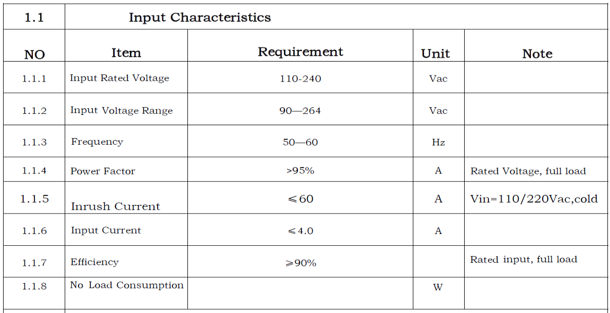

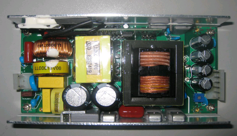

Who makes the PSU inside the unit? Do you have a datasheet?
I come from a background in electronics, and I can comfortably say that I have never seen an on-board power supply (hell, even an external supply) with a stated input voltage of 110-120VAC. I've seen 100-130, I've seen 90-136, most frequently I see something like 90-250 or 100-240.
Here in Ontario based on experience there's way more likelihood of overvoltage than under. Most sites sit at about 125-126VAC (250-ish leg-to-leg). If you are going to tell me that the power supply in the unit can actually handle 120VAC as an absolute maximum, I'm going to have to return it all, which is a damned shame.
But by example, a standard ATX power supply has a switch for 120 and 240... but when it's set to 120 it can handle between 90 and 145 volts (ish) in most cases (as long as it's not a 10 PSU)...
Been thanked: 1362 times
Re: Built-in Power Supply Specs
Tue Feb 17, 2015 2:56 pm
They are "rated" at 110-240V AC, which is the range they safely operate and perform to specifications.
Consistently operating outside this range can damage the units and significantly reduce the MTBF and void your warranty.

"Input Voltage Range" means that that power supply can safely and properly function between 90 and 264VAC. Which is what I was after.
Edit: It also shows a "Rating" of 110-240VAC, which means 208VAC is perfectly acceptable.
I would be willing to bet if you were to look at AC input voltage logs on your UPSs, you will have plenty of sites over 120V (provided they are grid tied).
Tue Feb 17, 2015 4:31 pm
Input range is what it "should" handle by design but is NOT tested, rated, or certified to do so.
The power supply will labor differently at different input voltages and will affect the MTBF and output rating.
Low input voltages is sometimes harder on a power supply then a little over.
