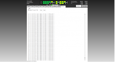

My Log on a ws-24-400B (1.5.0) Full of this, and has been since we got it....been ignoring it as the switch still functions.
Oct 15 04:58:53 SFP: FAULT on SFP 3, resetting...
There are 0 SFPs in the switch and the ports are disabled. Also as far as I know there is only 2 SFPs in this switch.

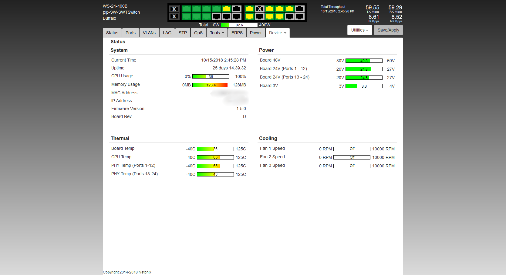

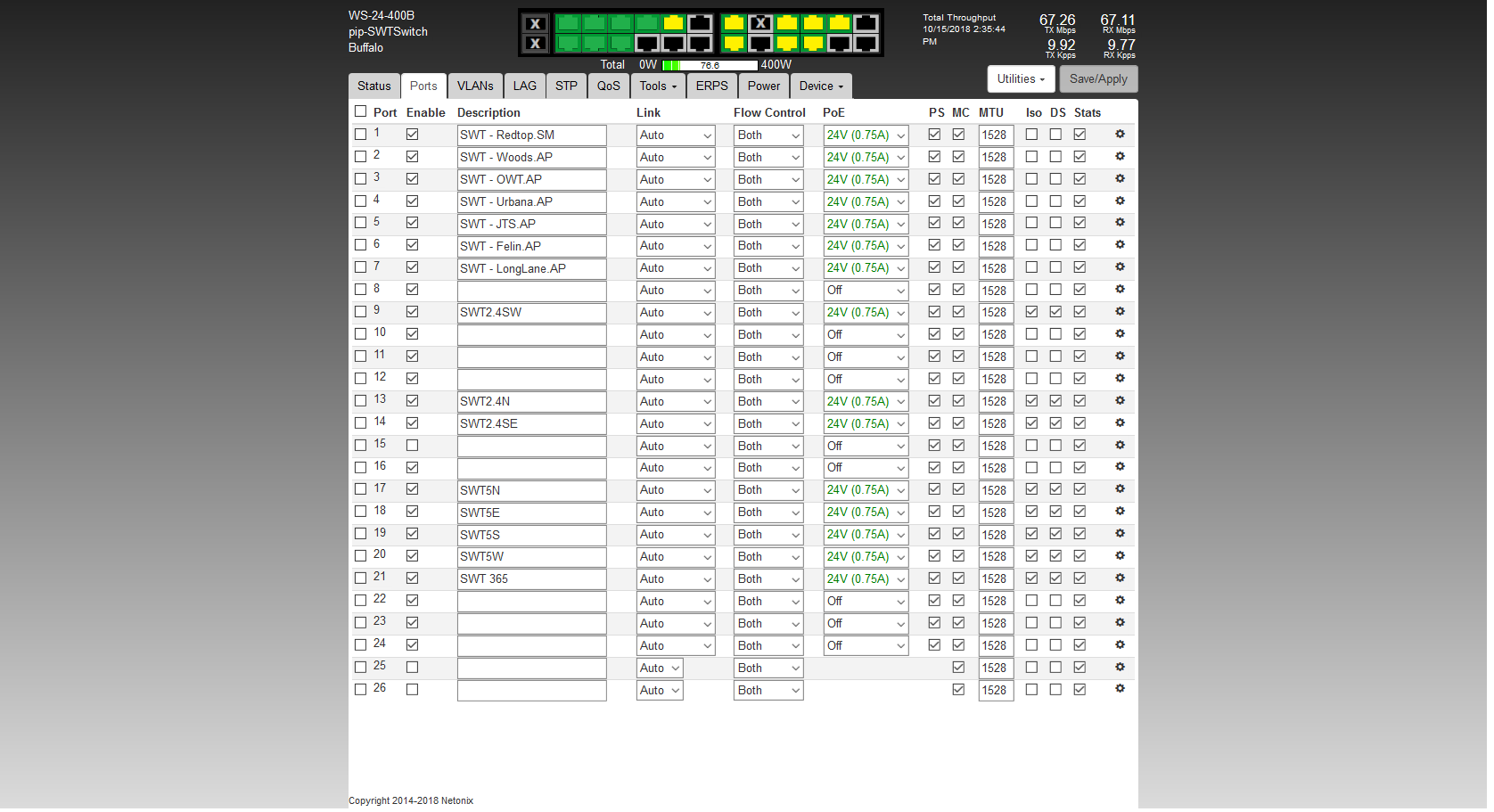

Added Device Status Screen

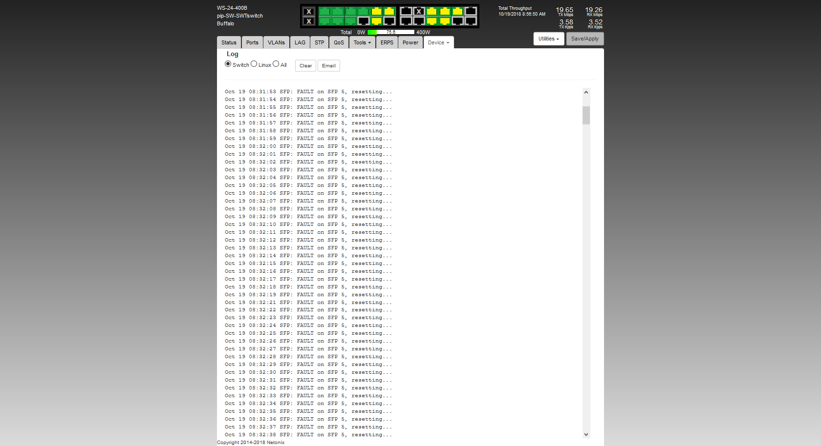

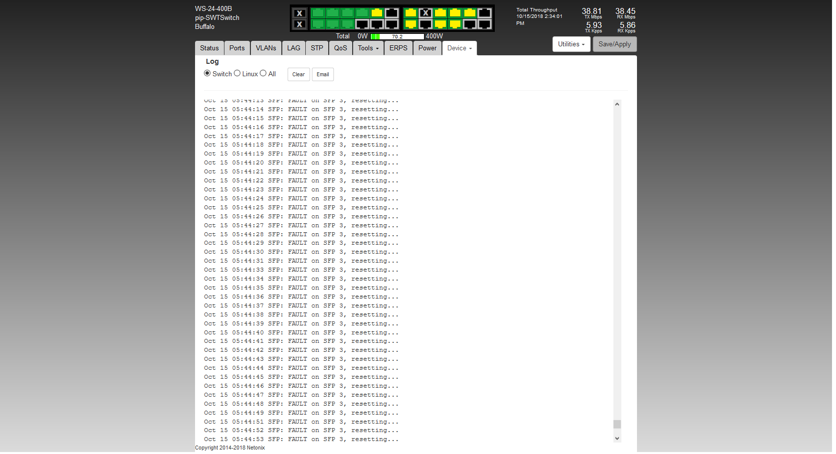

HEY SIRHC....... ITS BACK!!! But now on SFP 5????

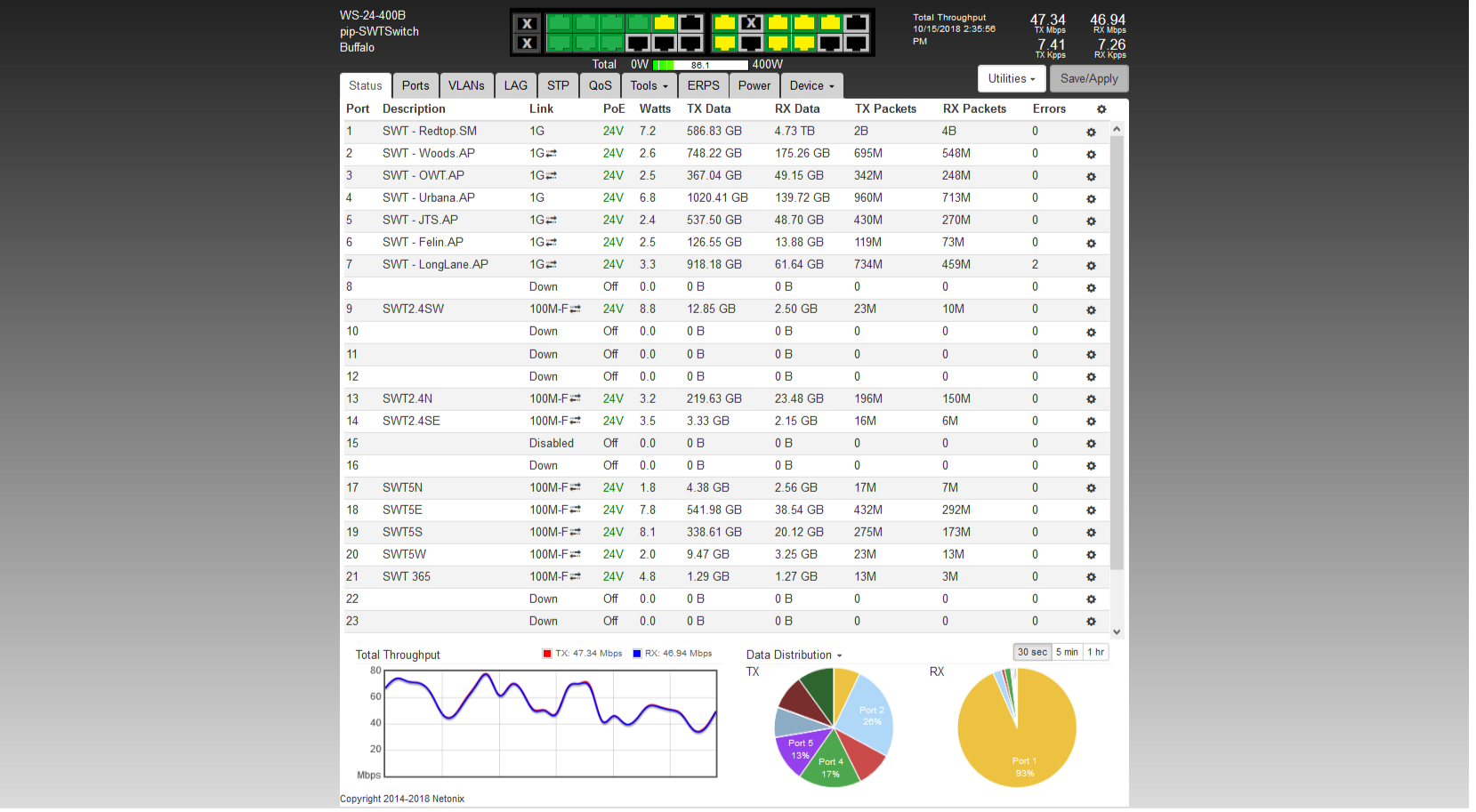

Re: Oct 15 04:58:53 SFP: FAULT on SFP 3, resetting...
Post up your Status and Ports and Device/Configuration TABs
Things to try:
Change the port setting on the SFP port from say AUTO to AUTO SFP or 1G
A different brand SFP module
Disable Discovery TAB
Other people are not reporting this issue including me and I have a lot of older WS-24 units in service so something about your unique configuration or setup must be causing this.
Things to try:

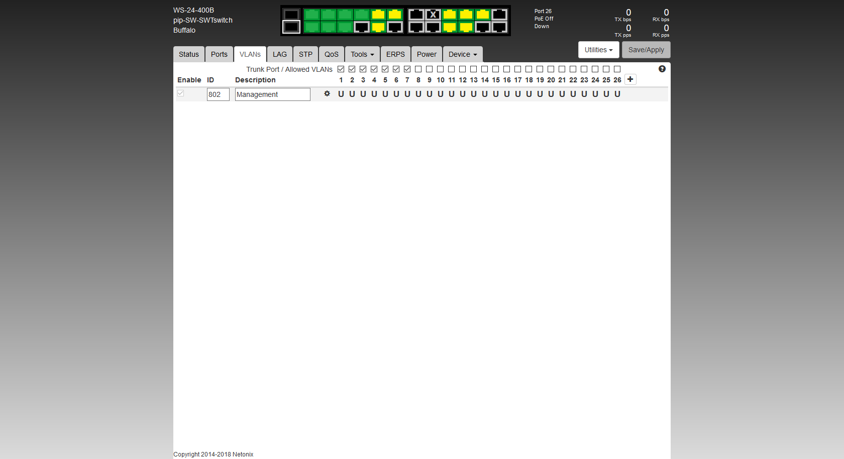

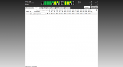

OK sorry;
Try not disabling the SFP ports even though there is nothing in them.
Also make sure the SFP ports are in a VLAN as if they are not this causing a port to be disabled.
SIRHC
Ok, enabled the SFP ports, however we do not use separate VLANs in this switch.
