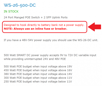

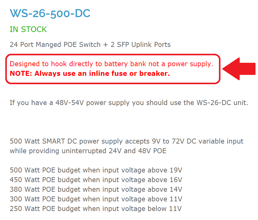

Regarding the Powerplant, the site is 24V Solar, so the switch is connected to the load output of the solar controller - as you can see in one of those screenshots the voltage is changing with day and night.
Re: WS-26-500-DC on 1.5.0 rebooted - thoughts?
Mon Oct 08, 2018 7:16 pm
My concern with it hooked this way is the charger and or controllers are not rated to 500 watts.
It is better to always hook our switches directly to the batteries (with an inline fuse or preferrably a breaker) and the controller hooked separately.
Your problem can be that the WS-26-500-DC draws too much power and the controller considers it a short or cuts out for a few seconds and reboot.
Why not hook switch to batteries and controller to batteries separately which is the way we designed the power supplies in the switches.
