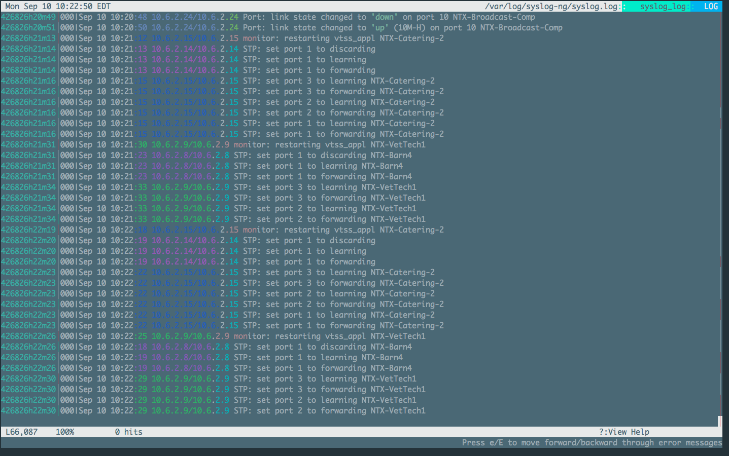

Hey all, I've done some searching on the forums for the vtss_appl logs and understand it's a system process of some sort. After (finally) pushing all of my currently active switches to a syslog, I've discovered a half dozen that are regularly restarting vtss_appl and causing packet loss and spanning tree changes. See below for more info, but I've removed the switches in question, updated firmware, hard reset, changed config and re-deployed in completely different locations and they'll eventually begin restarting vtss_appl again.
Any idea what the cause of this might be? I have a large inventory of Netonix and as I've been bringing them online and monitoring, it seems like a decent handful are experiencing this issue.
Thanks!

Re: monitor: restarting vtss_appl
Mon Sep 10, 2018 12:59 pm
What version of firmware are you using?

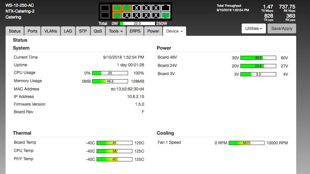

Mon Sep 10, 2018 1:53 pm
1.5.0, on board Rev F
Mon Sep 10, 2018 1:59 pm
As implied above definitely make sure you're running the latest software, vtss_appl is responsible for communicating with the switch-core about protocol configurations. So when vtss_appl is first started it causes STP restart as well. There are a few configuration changes that can cause vtss_appl to restart, however, in your logs it says that the 'monitor' is what is restarting vtss_appl which implies it is crashing. I've seen this happen a few times, the most common reason is a broadcast storm. Depending on your network configuration, maybe you need to enable loop protection? Again, also make sure all your switches are running the latest software.
**EDIT**
You're response came in right before I posted this so I couldn't see that you're running 1.5.0, might want to try 1.5.1rc4 as well, some work was done on vtss_appl

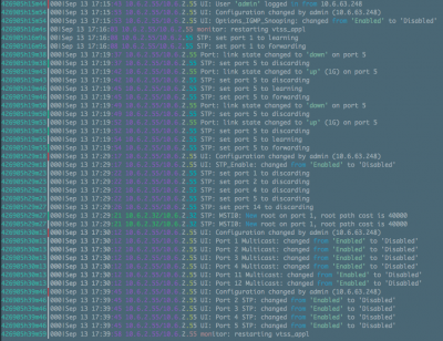

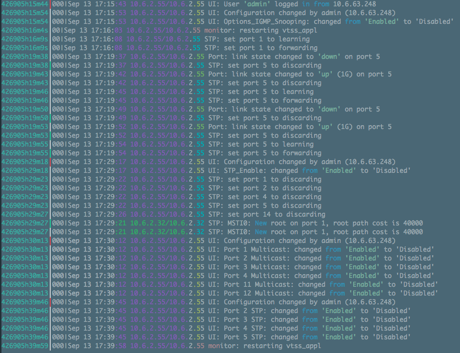

Following up on this -- it seems like passing multicast/IGMP is somehow related to these issues. See screenshot from my syslog where immediately after disabling IGMP snooping for an IPTV client off the switch, the restarting vtss_appl issue began where it had been previously never showed the error. There really isn't a lot of data (<50Mbps) crossing a single port at a given time so I'm not sure how to prevent this error from restarting RSTP an interrupting traffic without disabling STP altogether.
Any ideas?
Thu Sep 13, 2018 6:20 pm
Is IGMP snooping disabled on all affected switches?
We might be looking at a new bug here.
If possible could send a screenshot of the following tabs:
Status,
Configuration,
STP,
VLANs,
QoS
From a switch that is exhibiting this behavior?
