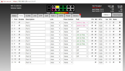

I have a WS-250-DC and when I enable the POE on a port it immediately shows that there is wattage consumption on the port
without any device connected.
As per the attached image I have turned on POE on P1 ,2, 5, 6 and although there is no devices connected to any of the port
it indicates a wattage overload in the region of 298W.
This must be a bug in the software? Can anyone suggest a possible fix or is an RMA the only option
Wattage overload without any connection

What version of the software are you running?
Re: Wattage overload without any connection
This is possibly a damaged current sensor(s)?
I would RMA it.
I would RMA it.

It is running the latest firmware and I have reloaded the firmware again just to make sure, still the same issue, therefor I assume it
has to be damaged current sensor

Most common cause of current sensor damage and the cause of 99% of WISP equipment damage is ground current.
I would add 2 NEW ground rods to electrical service ground rods and clean and corrosion on the connections.
Make sure electrical service ground rods are bonded to tower ground rods with #2 wire.
Another common cause for damage is a shorted cable or incorrect POE option applied to device.
