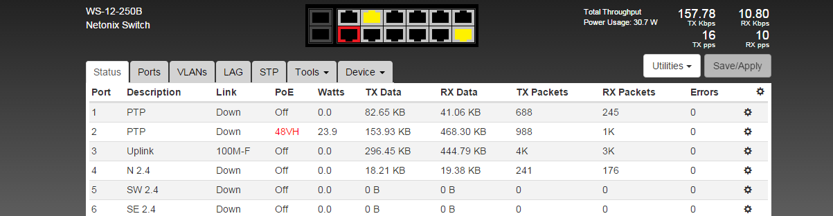

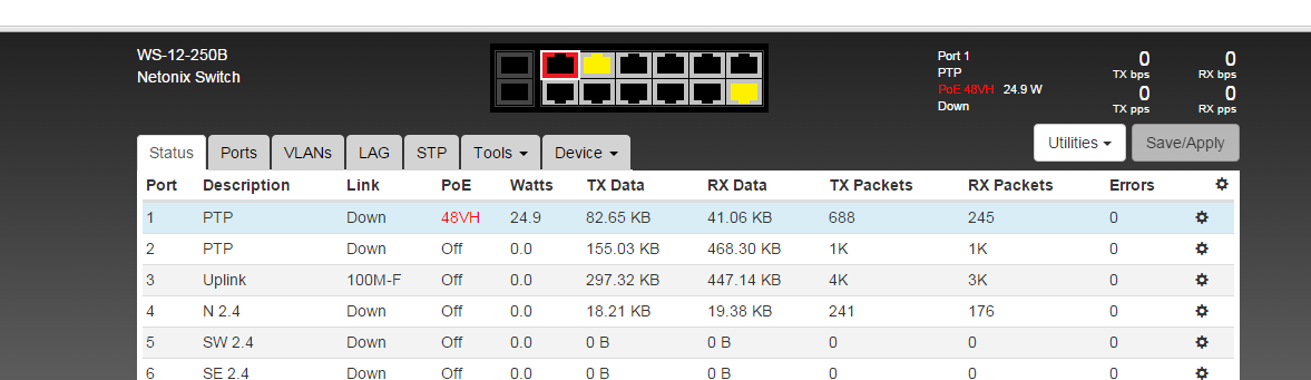

So I dug out a new AF24 out of the garage, tested on port 2 first, works fine.
I then tested port 1 , again 48VH, it worked.

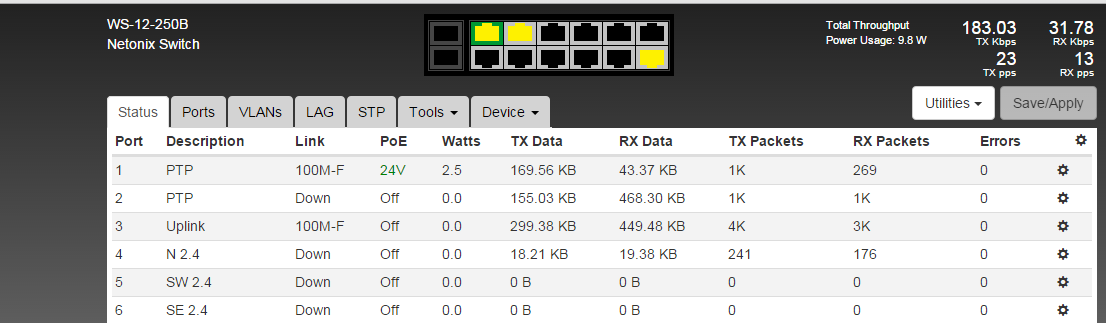

I then tested 24V on port 1 confirm it didn't work, and, now it works again. ? :hurray:
I tested port 1 over and over it never worked. It only works now after I ran 48VH through it. What ever that did, seems to have fixed it.
