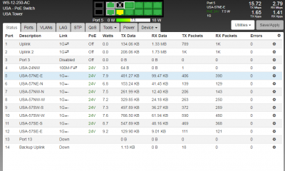

On July 20th and now again today August 2nd I have had a mass reboot of Rocket5AC-Prisms attached to a WS-12-250-AC switch that is powered via a UPS.
What is odd is that not all the APs powered by this switch are rebooting. This is not a watchdog issue either. The switch is not crashing or rebooting either.
Could this be a faulty switch?
On July 20th the following suddenly rebooted.
USA-57SW-W
USA-57SE-E
USA-57NW-N
USA-57SE-S
USA-57NE-N
USA-57SW-S
Today August 2nd the following suddenly rebooted
USA-57SW-W
USA-57SE-E
USA-57NW-W
USA-57NE-E
USA-57SW-S
In both instances USA-24NW (RocketM2) did not reboot.

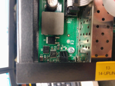

As I do not have any WS-12-250AC switches on the shelf under a year old I will probably have to do an RMA or mod it myself.
What gauge wire do you suggest for the mod? As I have to open it to mod it and break the Warranty tape will that void my warranty for other issues?

Re: WS-12-250-AC - Mass AP reboots
Mine does not seem to match the photo in the other thread. Mfg date of 2015.

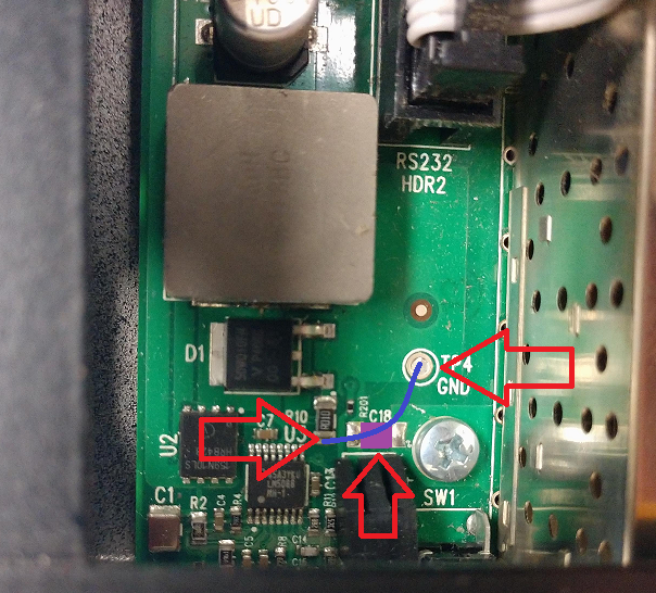

Read the post again on the 24V MOD:
viewtopic.php?f=17&t=3934#p24989
Notice below in the picture the imposed BLUE wire for 24V MOD.
Then notice the PURBLE block showing the ground MOD explained here:
viewtopic.php?f=17&t=2584#p18081
NOTE: I would do the Ground MOD first as it is easier than trying to do it with the wire in your way.
Another way to tell is if you look at the board's "white stenciling", not the white rectangular box Labeled "CFG" which refers to the firmware configuration to be used, if the white Stenciling says Board Rev H it may already have the MOD done as we had the SMT shop start doing the modification mid production run. If it says Rev I then your good. If it is Rev G or below you need the MOD. The important thing is to take a wire from the one side of the R100 resistor "as shown in the picture below" to any DC negative source which many of the old board Revs have a GND Testpoint right there near the R100 resistor.
